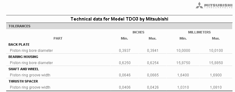

Some info I found online about the TD03 series. Use at your own risk as I can't guarantee it applies to the 8G

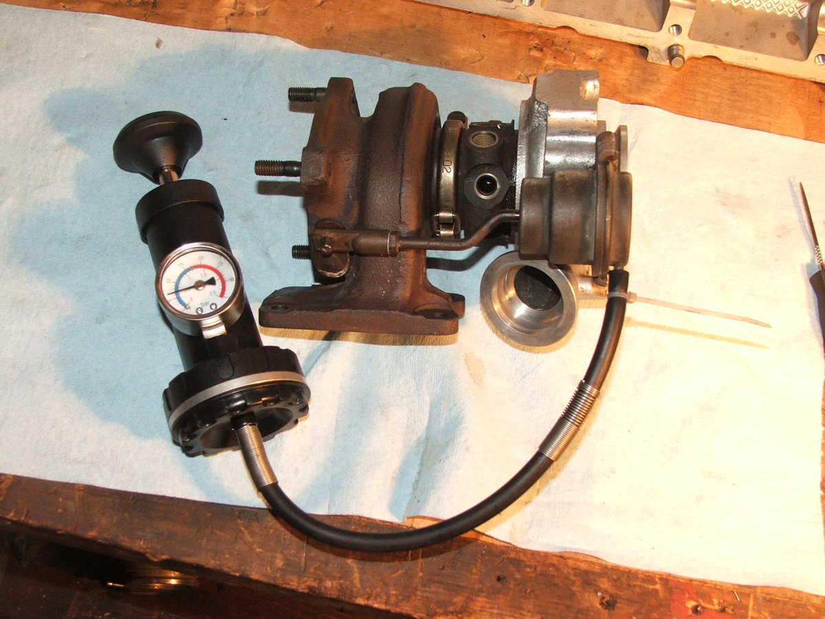

Setting the wastegate actuator pressure. I used a cooling system pressure tester pump
