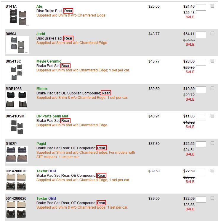

Now, I need some advice of REAR brake pads that don't squeal! Please advise for the best pads!
- Current pad: Volvo OEM pads, they squeal like a pig, I applied some anti-squeal compound, no difference, so I need to replace these Volvo pads.
In the past, I also had this issue with Volvo OEM Rear pads with my other car (1998 V70).
Anyway, I am looking at options:
- OReilly BrakeBest D31....$16 made in Mexico
- Autozone MKD31....$16: made in India
- Autohausaz dot com offers tons of choices as below:
