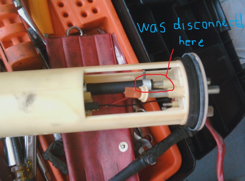

I have finally got to the junk yard. I bought a used fuel pump and two new fuel lines since I spliced the one going into the fuel filter to try an external check valve. I lowered the fuel tank just enough to get the new fuel line in and think I pinched it off when i put the tank back in place. I am getting no fuel now it seems. The problem I found was the hose on the fuel pump in the tank had come off on one side. I reconnected it and then tightened down the clamp. My question is do you think this is what has caused all my fuel problems? I am going to lower the tank again tomorrow and try to get the hose in a position to where its not cutting off the gas. The picture below shows the pump and where it was disconnected. I will also add a picture of the line I replaced.

The problem is fixed. car runs good. I accidentally switched the lines on the fuel pump! All good now!
