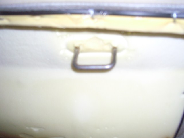

First, remove the bottom cushion of the rear seat by tugging upward on the front edge of the bottom cushion. The metal hook/loop attached to the cushion will snap apart from the black plastic clip that is attached to the seat frame.
Here's what it should look like with the bottom cushion out (note that the headrests have already been pulled out - I explain how to remove them in the next step):

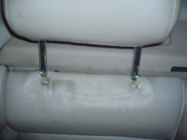

Pull the headrests straight upward and they will come out of their white plastic sleeves (hidden in the back rest).

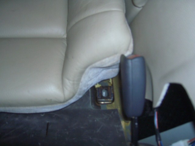

To remove the back cushion, look in the bottom outside corners of the cushion (next to the female seat belt coupler). Remove the one both on each mount. The nut is welded into the metal car body so don't worry about holding the nut with a wrench.

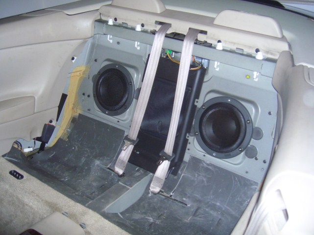

Here's what it will look like with the backrest cushion out:

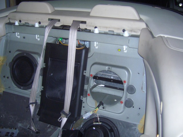

Now unscrew the speakers using a star socket (provided with your Volvo emergency tool kit). Carefully protect the speaker wires (wrap with a shop rag) as you rest the speakers on the base of the seat frame (the edges of the metal are sharp). The speakers are soldered to the wires as opposed to detachable clips.

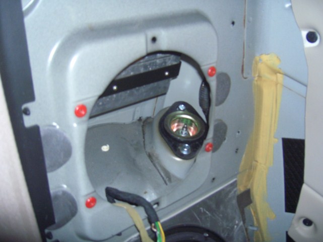

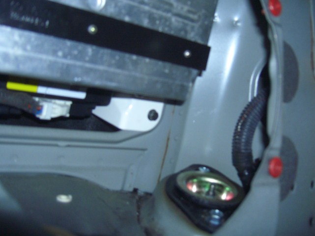

The shock mount is located behind the speakers in a corner:

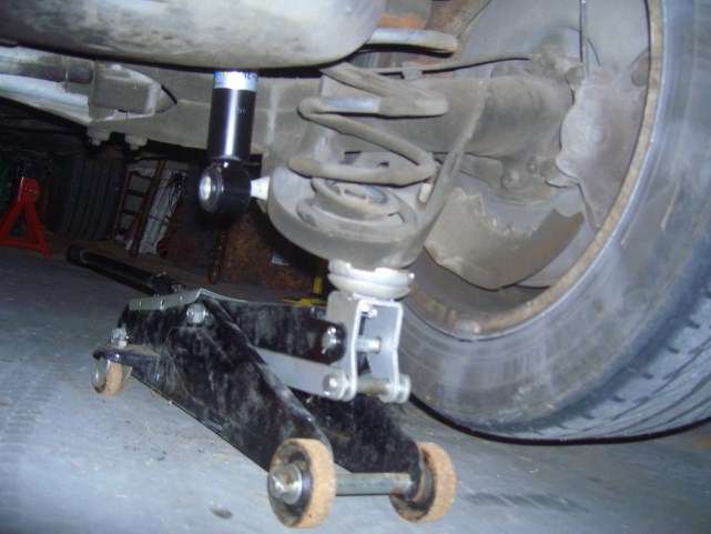

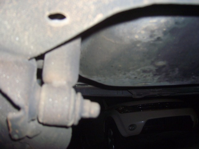

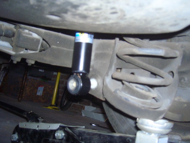

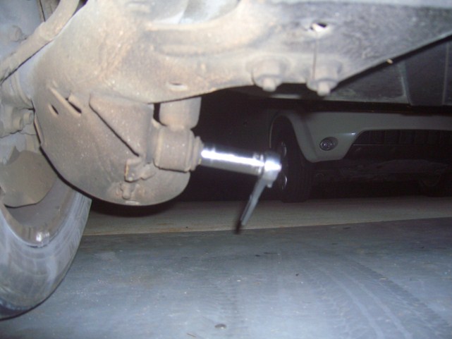

Next, go under the car (make sure the car is securely on jack stands and not just on a jack). Unbolt the domed locking nut from the bottom of the shock and remove the washer. Pull the shock away from the bolt. (The bolt is welded to the suspension arm so don't worry about having to hold the bolt with a wrench).
Now the shock should be completely free from the bottom suspension trailer arm. You will be able to wiggle it around because the shock mount at the top has rubber bushings. The shock will not fall down though because it is still bolted to the upper shock mount.

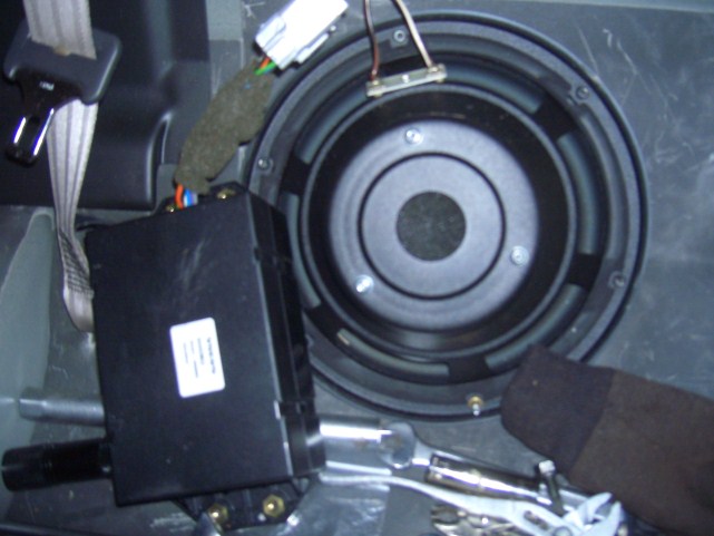

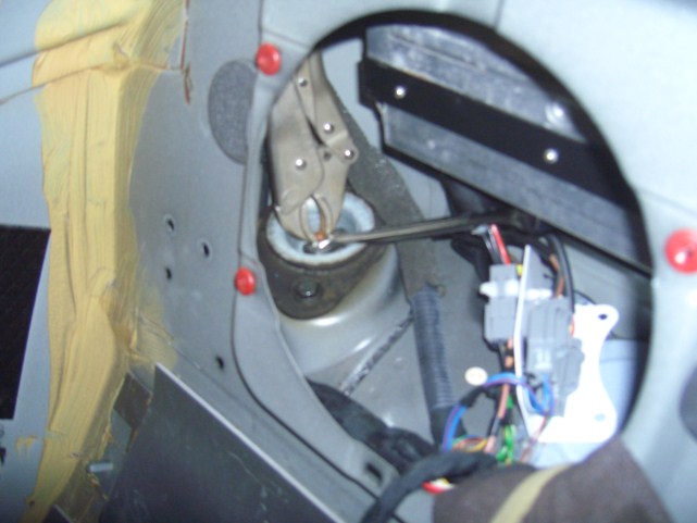

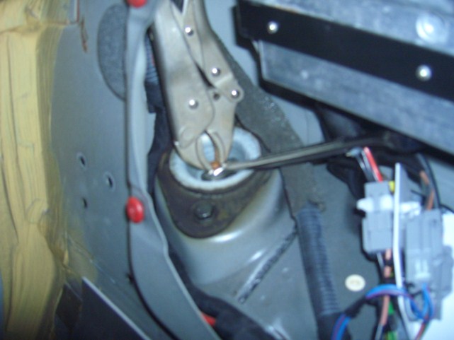

At this point, you can save a ton of time, headache and sore hands by having the specialized Volvo tools that hold the top of the shock bolt while unscrewing the bolt that secures the shock to the top mount (all in a very tight space). I did not have those tools so I used vice grips and an open end wrench.

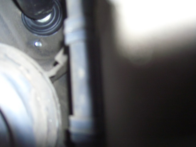

I first removed the black plastic boxes (in this picture hanging next to the speaker)that are bolted to the inside of the car body and in your way:

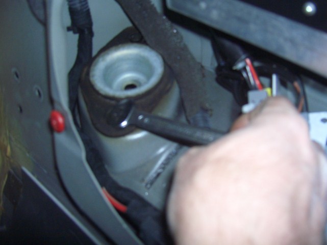

Here's what unbolting the shock mounts looks like:
Success! The nut is off the bolt, the shock fell down to the garage floor, and the old mount is sitting there waiting to be easily unbolted. The nuts are welded to the body of the car so you do not have to worry about holding the nut with a wrench on the other side.

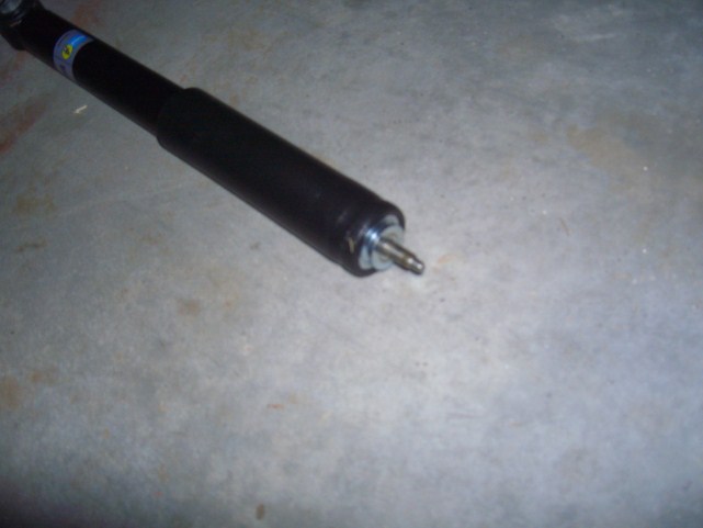

Get your new shock out of the box and remove the nut that is included with your new shock (nut is off in this picture). I bought Bilstien TCs and I'm very happy that I did. The Bilstiens came with a top nut that has a locking feature but I also used the blue thread locker gel. Make sure to leave the included washer on the shock top bolt:

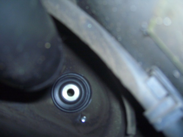

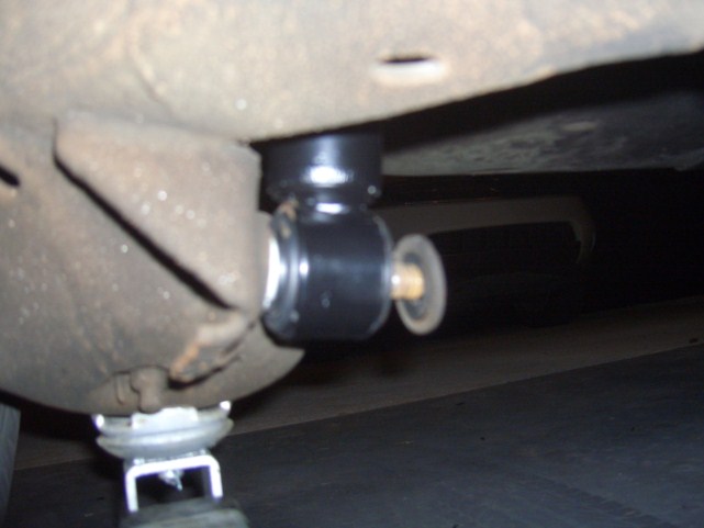

Get under the car and guide the shock up into the shock well - here is a view looking up with the new shock mount installed:
Make sure that the washer is on the bolt (washer will be positioned under the shock mount) and make sure that you watch the top bolt on the shock enter into the new shock mount hole:
Now that the bolt has traveled into the shock mount hole, see if you can insert the bottom of the shock onto the suspension arm bolt. If you cannot, you will have to use a jack to raise the suspension arm high enough to allow the shock to slide onto the bolt.
Put some blue thread locker on the domed locking nut. Replace the washer (OK is it has a little rubber on it from previous shock) and then attach and secure the domed locking nut. I don't have the exact specs but I tightened the nut to about 80nm torque.
