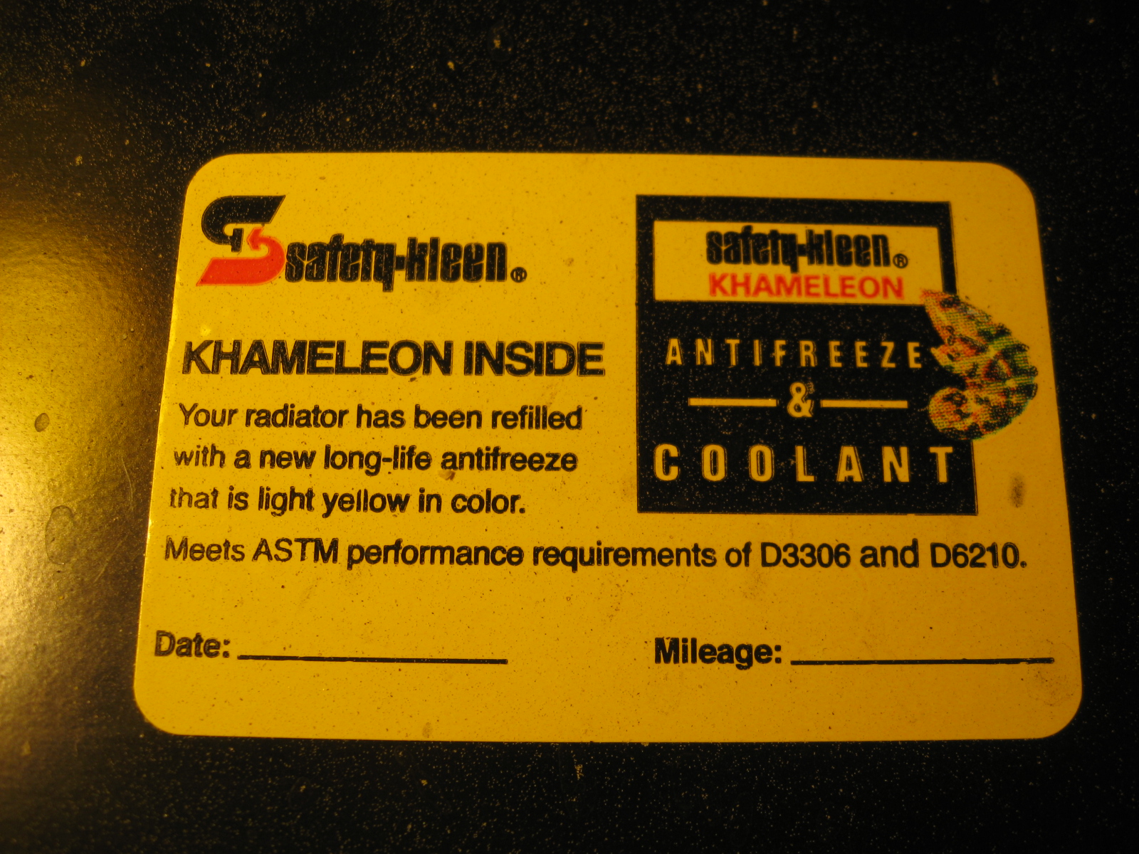

Just noticed this sticker: I guess the PO has this type of coolant in the xc90. Is this good or bad coolant? Should I flush it and put in volvo coolant? Any good write up for flush and fill on the xc90?

Just looked it up . it is a HOAT without silicates using benzoic acid.
It uses benzoic acid on top of glycol instead of Volvo's brand which has Glycol, sebacic acid and some silicates.
I would use good distilled water and Volvo coolant to gain the added effect of the silicate.
