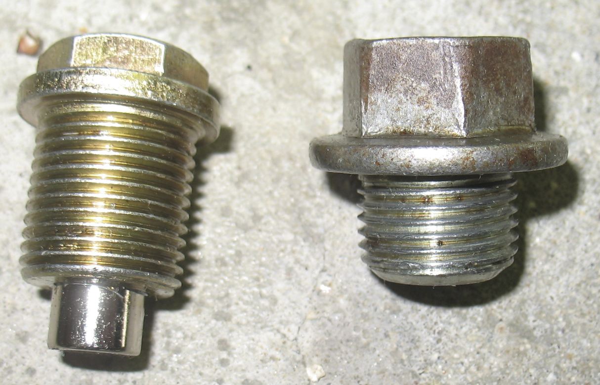

Hey guys, as you can see I have two oil plugs - on the left is the magnetic one I got from FCP and on the right is the original. When I was installing the new one, it didn't go in all the way. Is it supposed to be this long or is this the wrong one for our cars?

So the real question - is the one on the left too long or are the threads in my pan f'ed?

I've put a couple of the magnetic plugs in and the thread length is indeed a few millimeters longer than the original plug. With the first I reasoned that the innermost threads in the pan were not cut all the way because I could not feel anything else that could be preventing the plug from going in. So, I just worked it in carefully and it seated OK and has been fine ever since.
With the wagon, I had the pan off to do "O" rings and put in the mag plug at the same time. Looking inside the pan, I could see that my earlier theory was correct; they did not run the tap clear through the hole and the innermost bore doesn't get threaded all of the way through. I worked in the magnetic plug while watching it on both sides and didn't see any damage, it just cut the final thread or so.
So, I was successful for two. Just work it in carefully, back and forth for a bit and I think you will be fine. Another option would be to grind or turn down the outermost 2 or 3 threads of the plug.

the magnetic one looks the same if not a little shorter than stock.
The early ones are 18MM long w/o seal and late ones are almost 23 mm long.
The threads are cut full length so the longer will fit early cars originally having the short ones.
