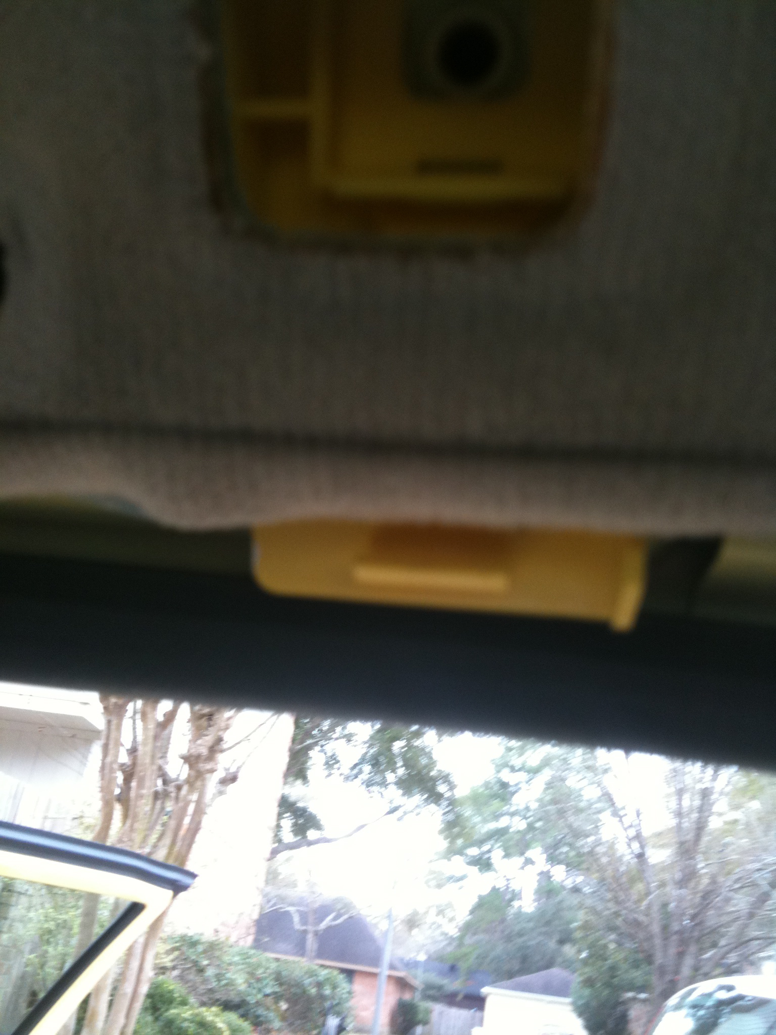

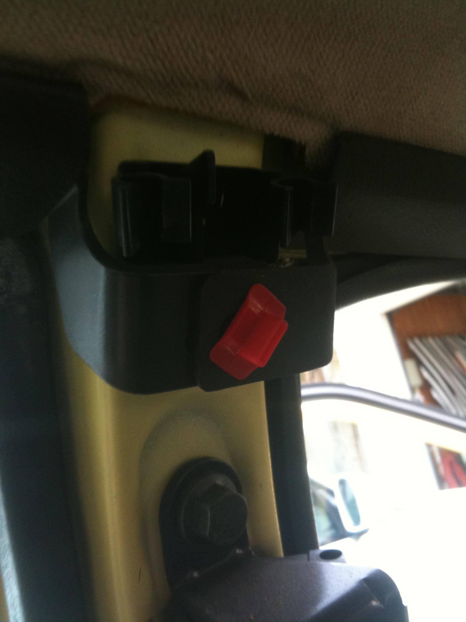

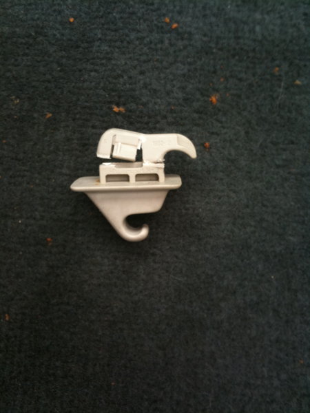

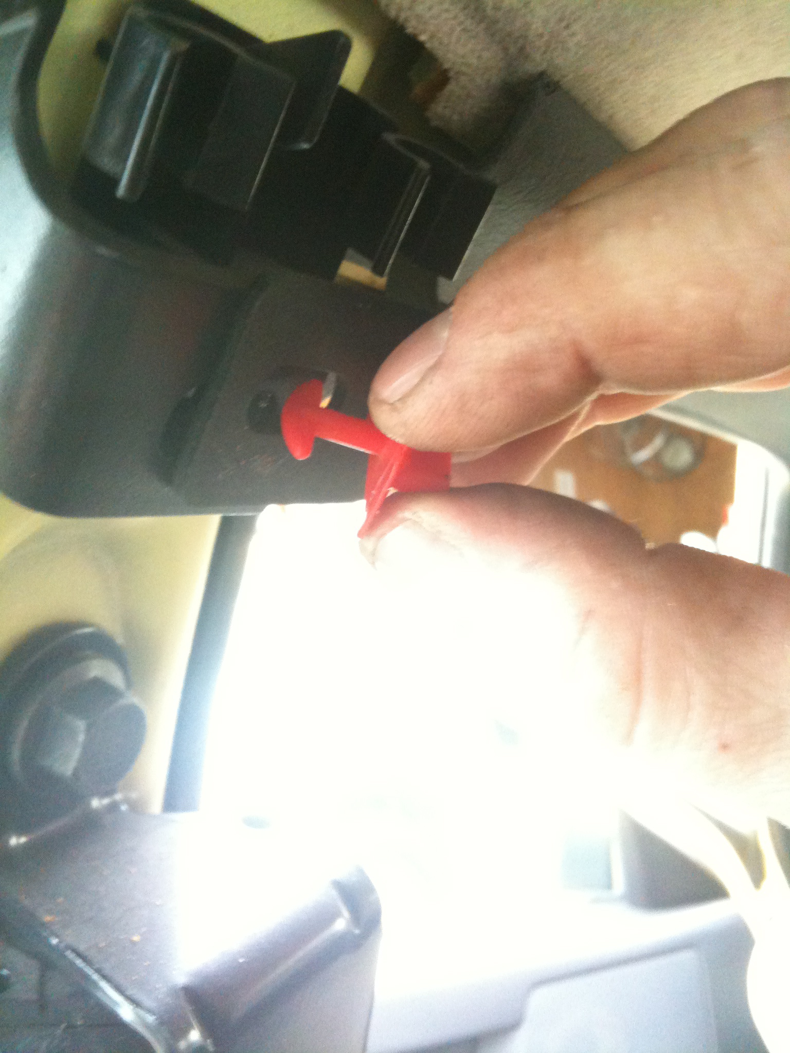

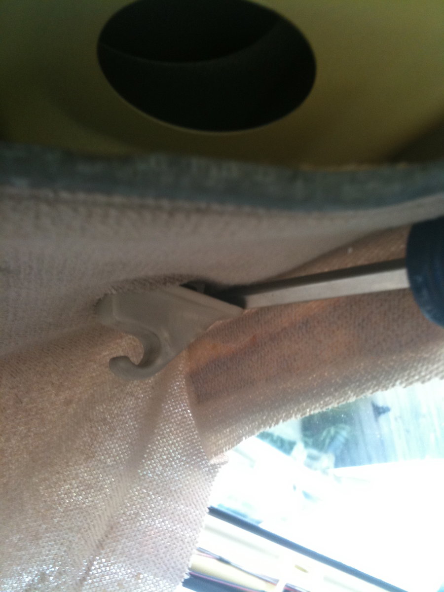

Here are some of the pictures I was talking about. I hope it helps you get an understanding of how they come out.
This one is behind the center post Holds up headliner Just pulls out Just pull out red tab Do not pry this one out, it slides one direction and comes out My broken tab
