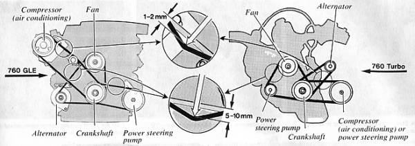

This cycle keeps on repeating its self. is the coolant low? Also found out there is only the A/C belt on the compressor the it looks like there should also the Altenator belt running over it also. I could not find any belt info on here. Thank you very much you guys know it all.

The 760T has three belts as shown in the attached:
760 belts.jpg (30.31 KiB) Viewed 994 times
Has the AC been converted to R134a or is it still using the original R12? If the latter, you can not use R134a to top up. The 'coolant' level is checked by weight, usually working from a fully evacuated system. Your car would have 1100 grams of R12 when it left the factory. If it has been converted to R134a it would have 900 grams of that gas.
