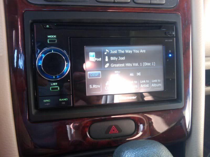

Where can I find a Double DIN dash kit like the one shown above? Can't find one for the life of me...
