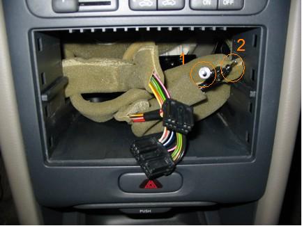

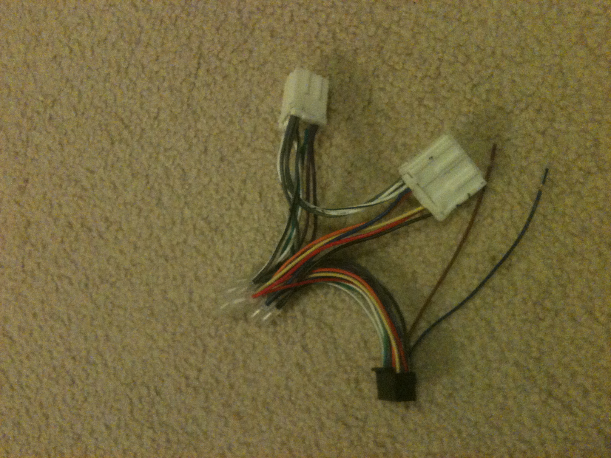

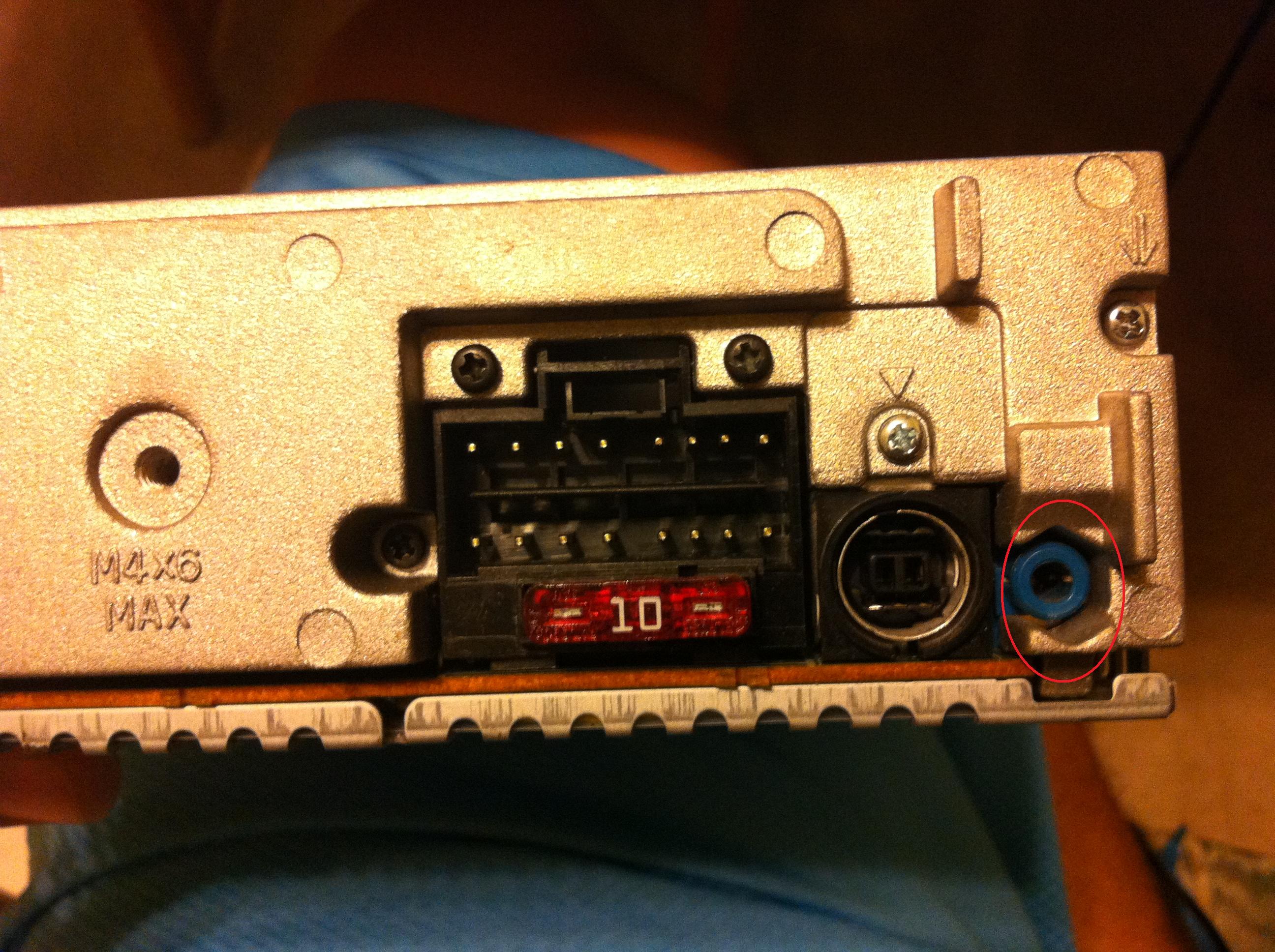

I connected the wires by matching the colors as shown in the attached pic.
I have 2 wires free, one is AMP TURN ON and MUTE.
When I pull out the stereo, there is two different cables, I know one of them is the antenna, but there is another one just like it. Little bit thicker. What is that one? I marked them as 1 and 2 in the picture.
When I hooked up the harness and those two cables to my new stereo, the lights came on the stereo but none of the buttons functioned.

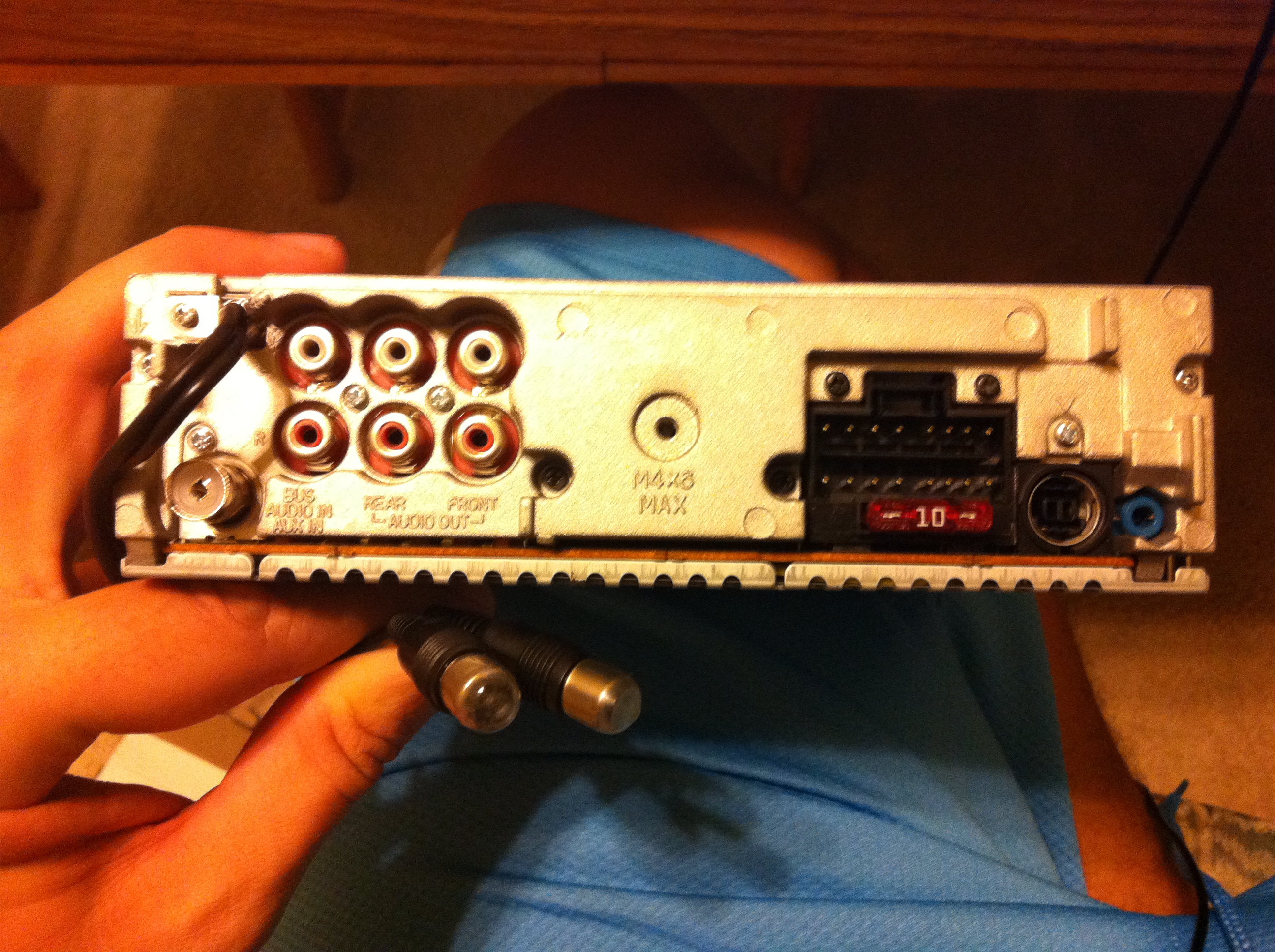

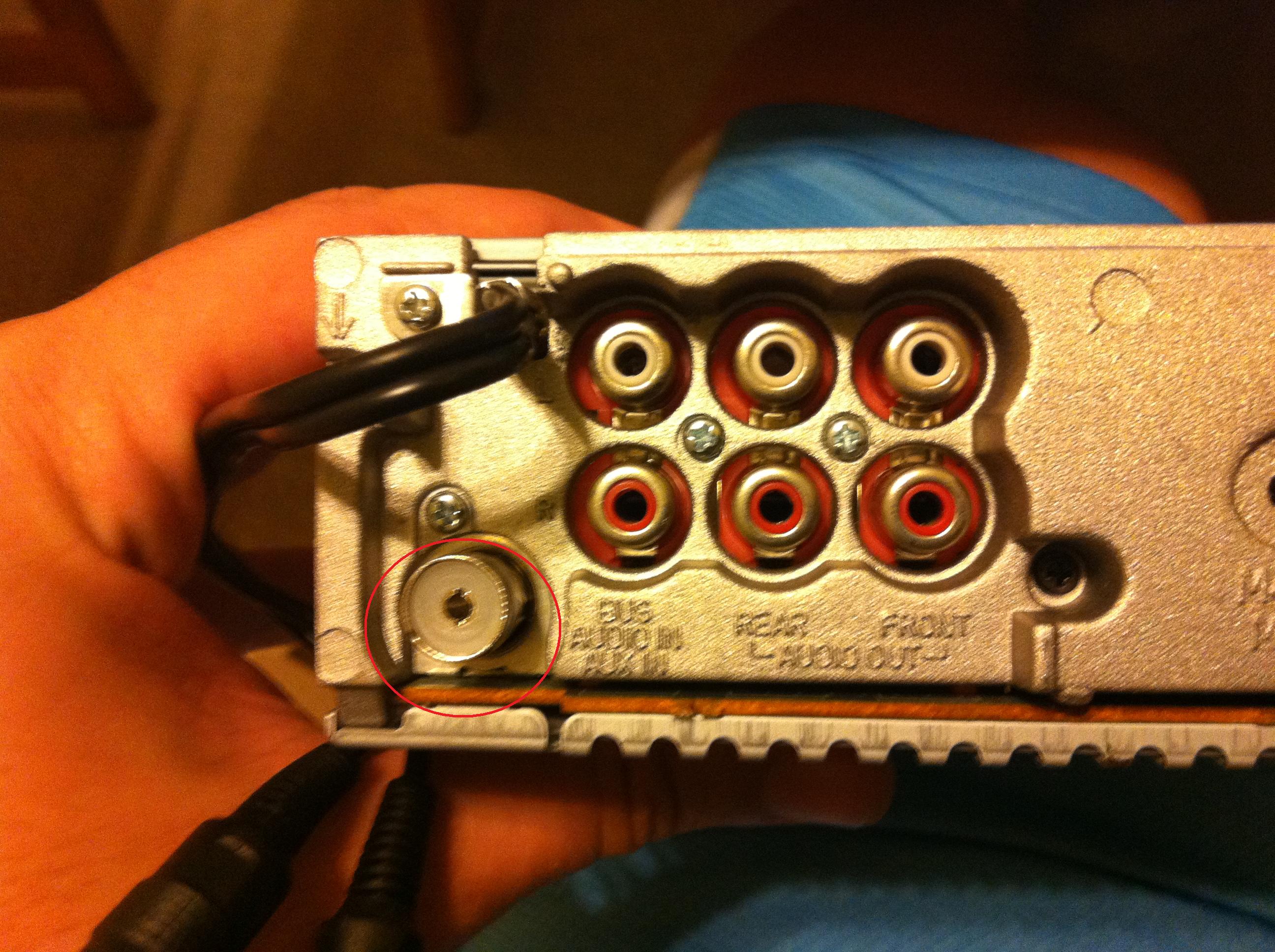

I hooked the antenna cable and the other cable that looks like the antenna cable on the back of the stereo where I circled.
Where do I go wrong?

The S70's had an optional two antenna system called "Diversity Tuning".
It has a regular antenna plug and a smaller "Mini-Me" antenna plug.
The big one should plug right in, but in the pic, it looks like there's
an adapter in the antenna jack in the lower left of your new HU.
Pull that adapter out and the antenna should plug right in.
As for buttons not working - Is there anything on the display?
Have you got a meter? Check power on the red and yellow leads.
Yellow is constant power and Red comes on with the key.
Be sure that they both have juice when the key is on.

Thanks for your response.
Yes, the display and everything else is lighting fine just like the way it should be.
I will check the power this week.
I plugged the "1" into the blue circle and "2" into the white circle when I did this.
I thought one of them is power the otherone is antenna.
I've never installed a stereo so I just plugged those to where ever they fit

The blue jack looks like an external audio input.
The white, again, looks like an extra adapter for another market,
like maybe Europe, plugged into your antenna jack. Did it unplug easily?

Agreed. take the one out of the blue jack. It could be anything - like a remote mic input or something. Sounds like you don't have the power hooked up correctly. Look over everything pay close attention to the 2 power - acc and hot (bat+). check the ground and the power antenna lead. I used the amp lead from my new stereo to raise the power ant since there was now power antenna lead.

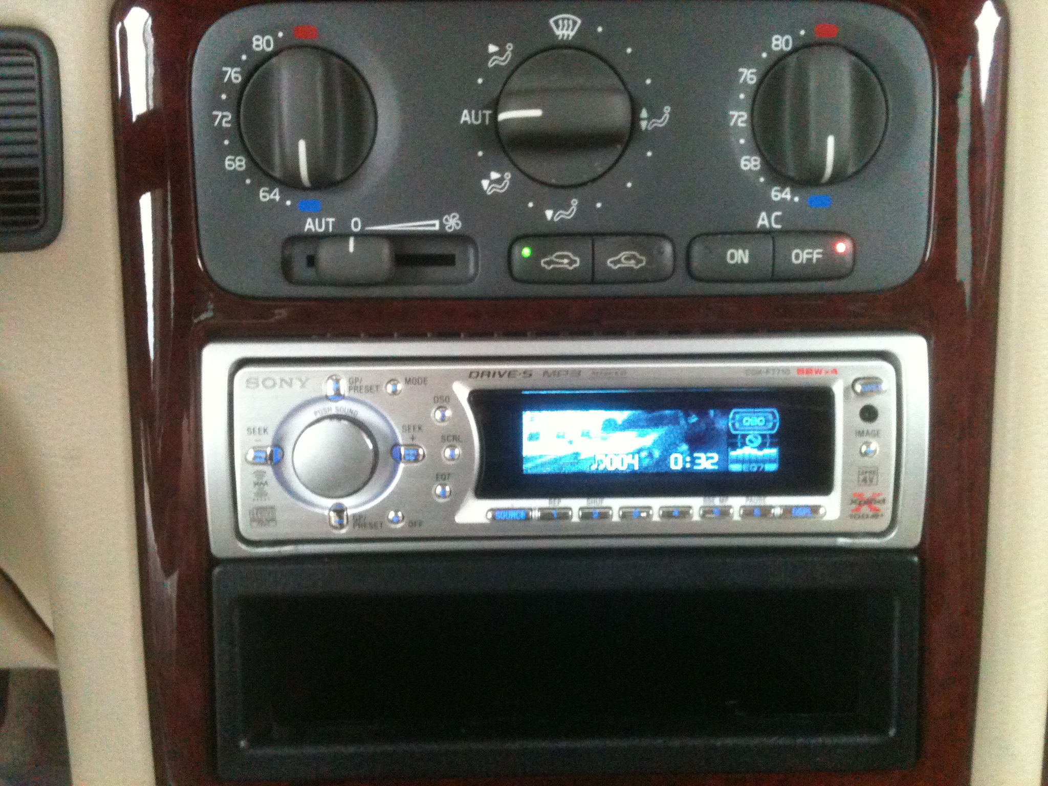

Success!!
I installed the stereo finally, the problem was plugging the other power cable into the stereo so that cause some conflict I guess, I just inserted the harness to the stereo and everything worked (and antenna).
