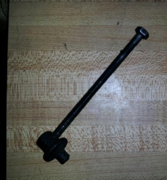

Changing belts this weekend, we had to grind off the end of this thing to get it out.
What's it called, and where can we get a replacement? (see pic)

that is your belt tensioner you should be able to find new at dealer or a wrecking yard these were used in 240 and 740 mod

I love a challenge. If the part is from the alternator then I think it is part #7 on the attached:
740 Alternator mounting parts.pdf
(134.39 KiB) Downloaded 142 times
You may be able to pick one up in a breaker's yard or, for new parts, check our sponsors at the top of the forum. Their ads are links to their sites. Two of them do list this.
