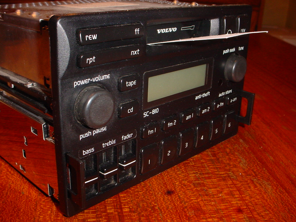

The ECC controller, as stated, comes out of the dash quite easily. You are correct that it is a "system" but the control module is the heart of the system and all signals begin and end at the controller. To remove the controller first remove the radio which is done by depressing tabs on the face of the radio that are - more or less - next to the bass slider and number 6 preset. I just use the key to press them in and then let them pop out. At that point the tabs act like handles to slide the radio out. The wiring harness for the radio is long enough that you don't need to unplug it.
Radio Release Tabs
Radio Release Tabs
If you do unplug it you will need to have your 4 digit radio code to get it to function again.
Once the radio is out of the dash it is simply a matter of reaching through the hole where the radio lives and then pushing the controller out of the dash. It will put up some resistance at first and then just pop out.
