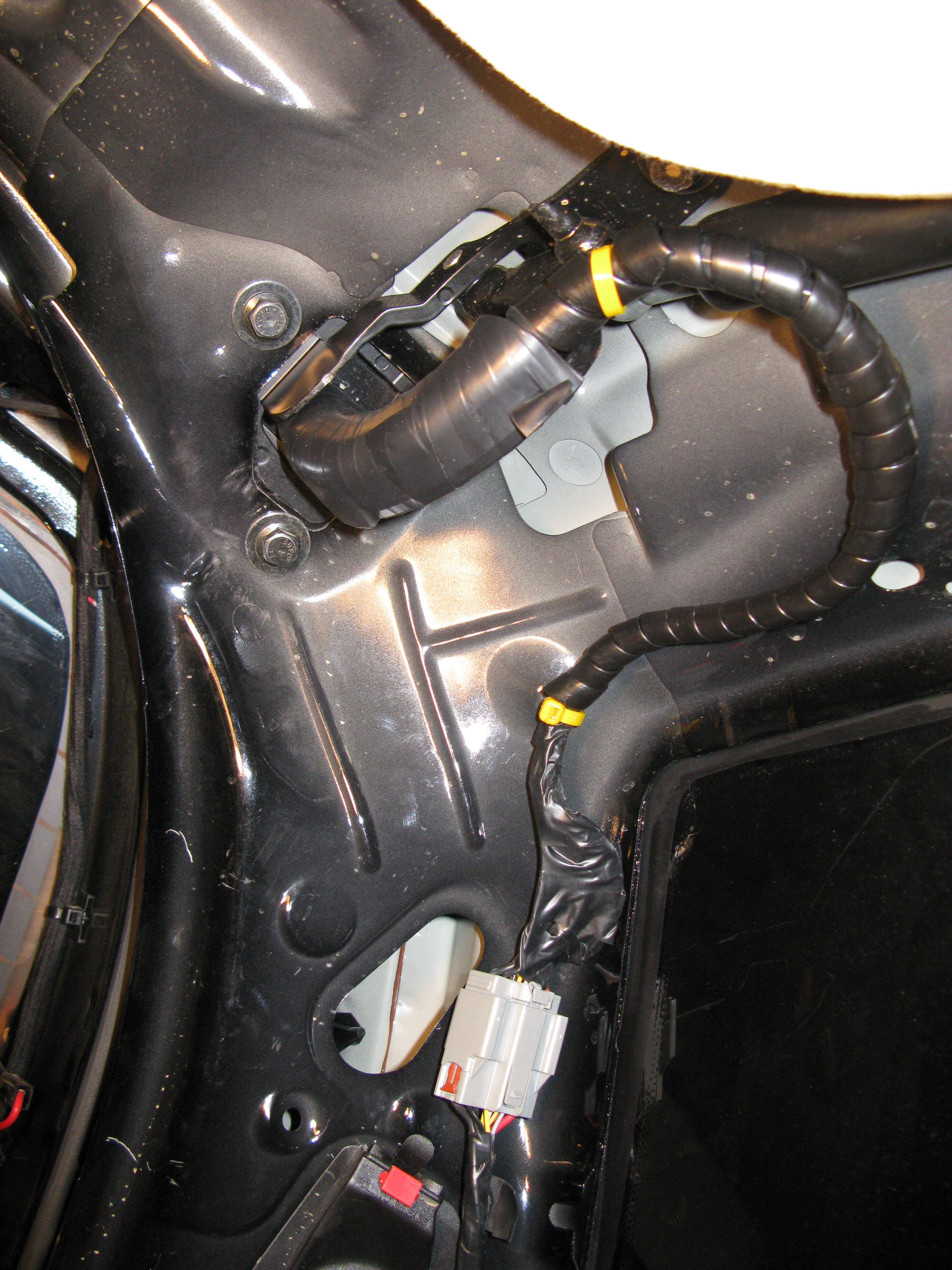

Here are three pictures of the hydraulic hose reinforcement of the wiring harness utilizing "Hose Wrap Spiral" as detailed in two posts previous!
Wrap encompasses from hatchback / door rubber grommet to 54-50, a 14 pin connector at roof pillar post.
One picture of the hatchback / door open, the other closed.
Bullet Proof!
Bullet Proof!
