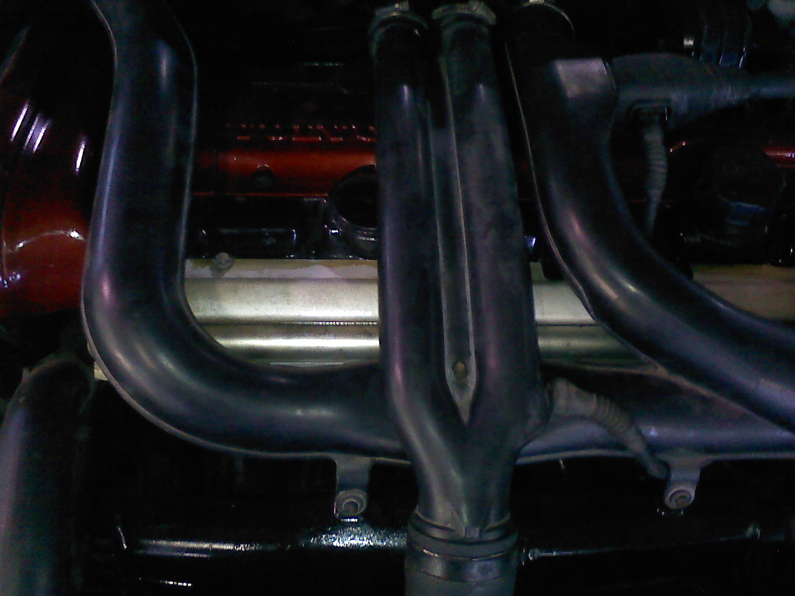

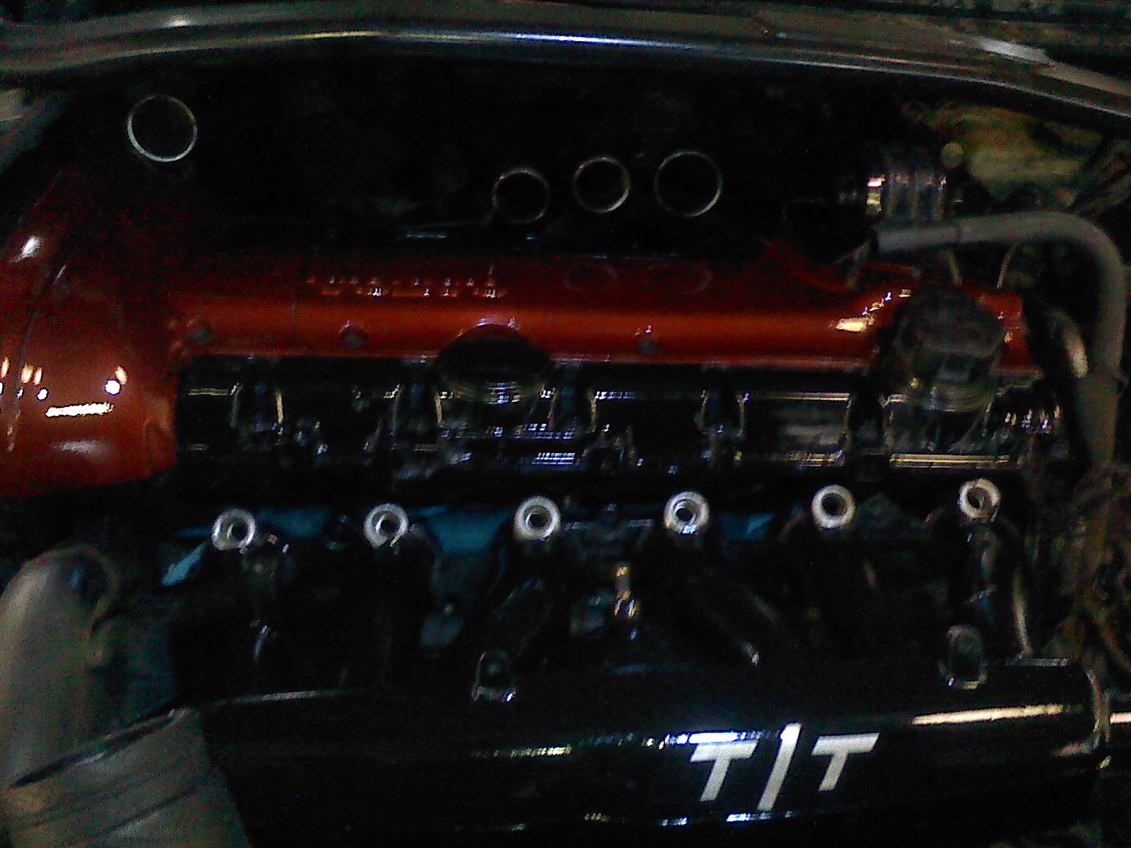

OK... it works. I just got started, but this is the result so far.vjaneczko wrote:Not that I know of. I'd avoid spraying any of the metalic stuff but since it's a 50/50 mix, it's not going to be a huge problem.
[img][/img]

Nice Job! Looks like you even rubbed the firewall heatshield with a rag to buff it up a bit?

Yes, I did. Now its time to get out the toothbrushes....vjaneczko wrote:Nice Job! Looks like you even rubbed the firewall heatshield with a rag to buff it up a bit?

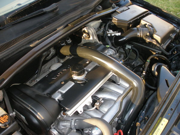

dbm123's engine compartment looks amazing.
If your engine compartment is really neglected you will need some harsher cleaning. But if you want to maintain it and keep it looking like the above picture, regularly cleaning will work with milder cleaning. I use Simple Green. Its more environmentally friendly and much less harsh. I warm my engine slightly, turn it off (so there isn't air rushing around), spray Simple Green all over and especially on the dirty parts. I let this soak for 10 minutes, then restart the engine and blast everything with my power washer using the gentle wash nozzle.

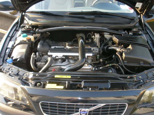

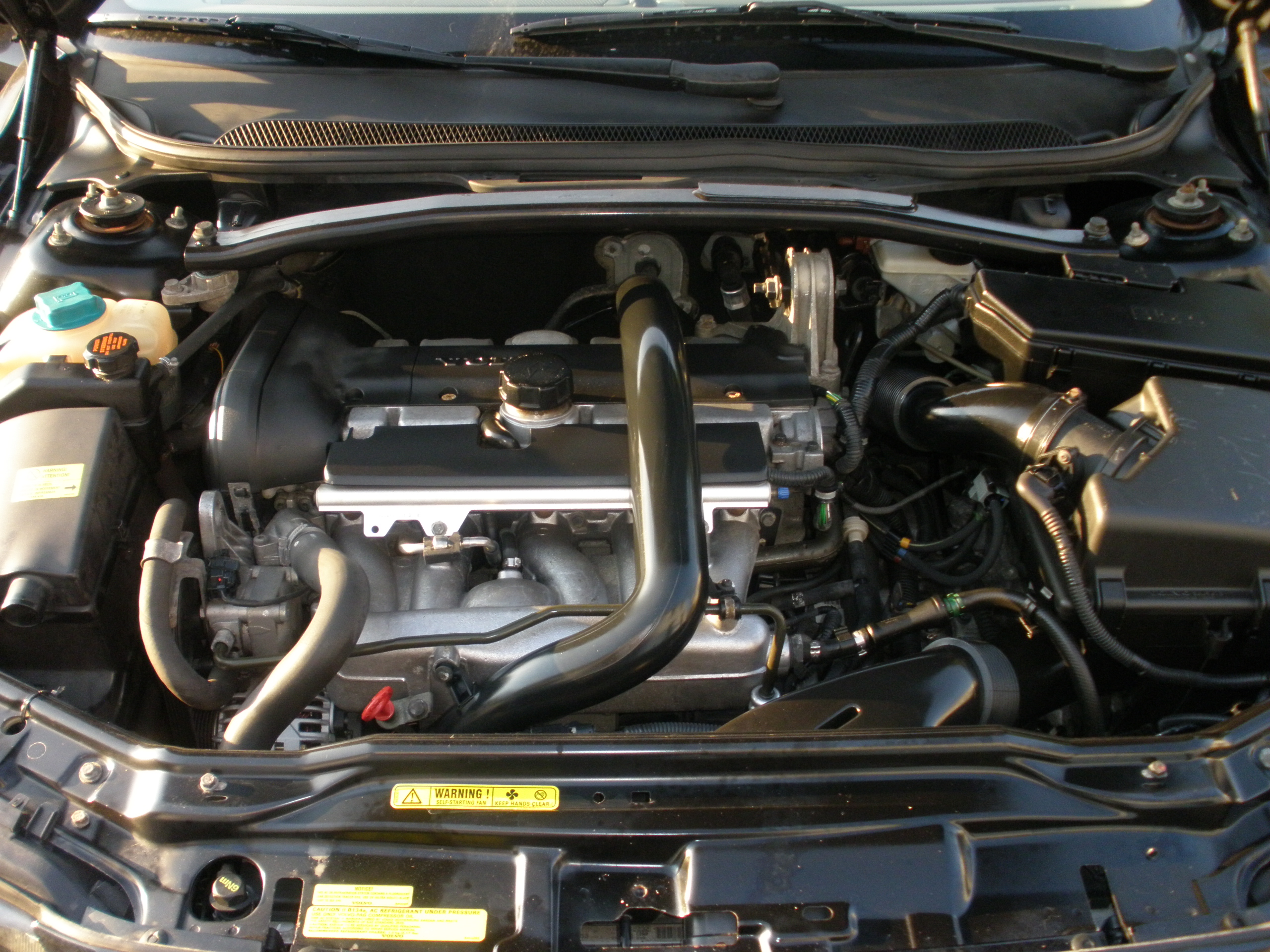

I made a 1/3 mixture of Armor All and water in an old spray bottle. Instead of my prior technique or spritz and wipe, I doused everything (except parts which shouldnt be sprayed obviously) and let it air dry. The results were terrific. The sheen was a little uneven until after a full day and some driving - which dried everything out evenly. There is no stickiness.
This is my 11 year old, 142000 mile engine compartment
