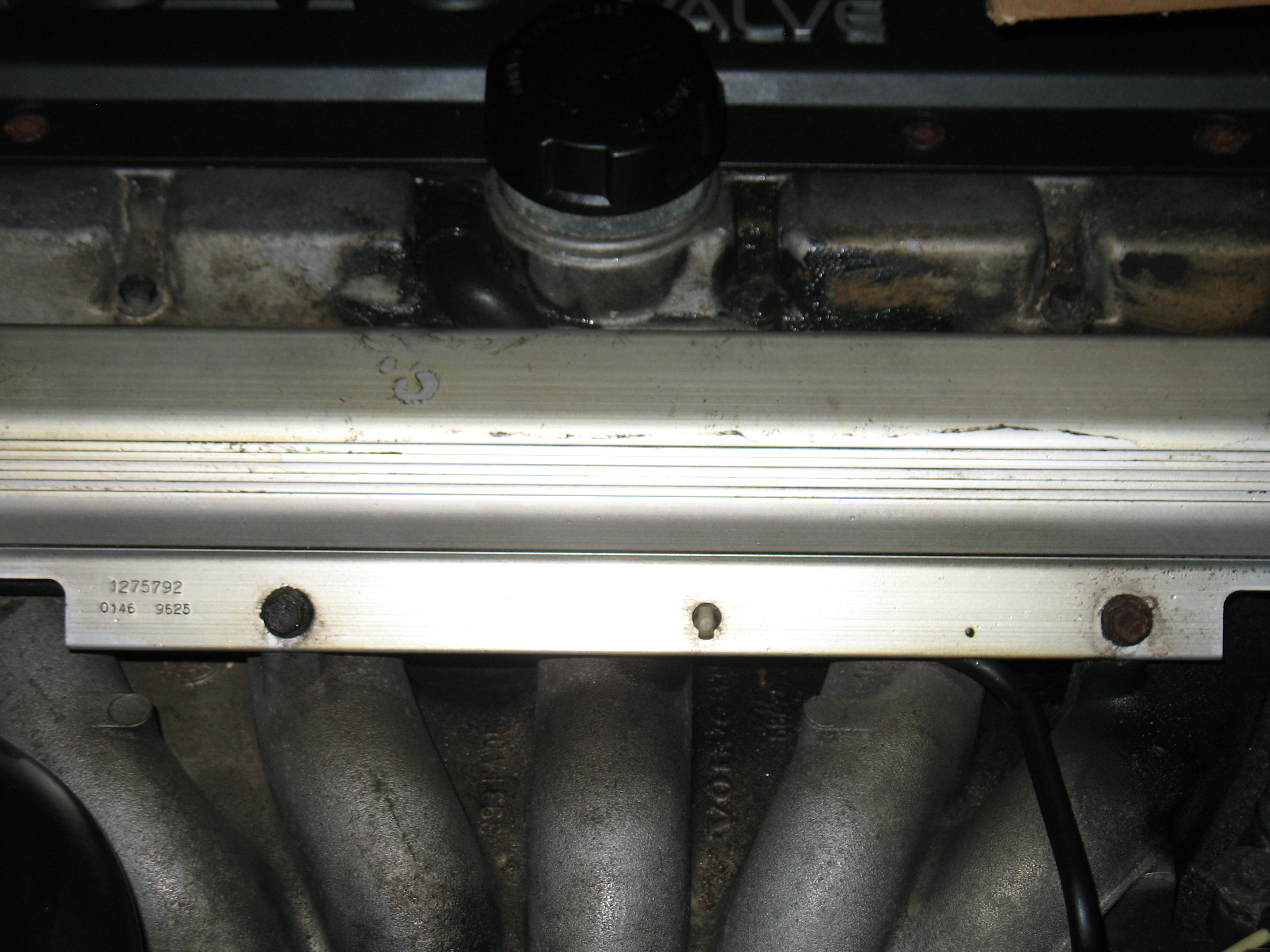

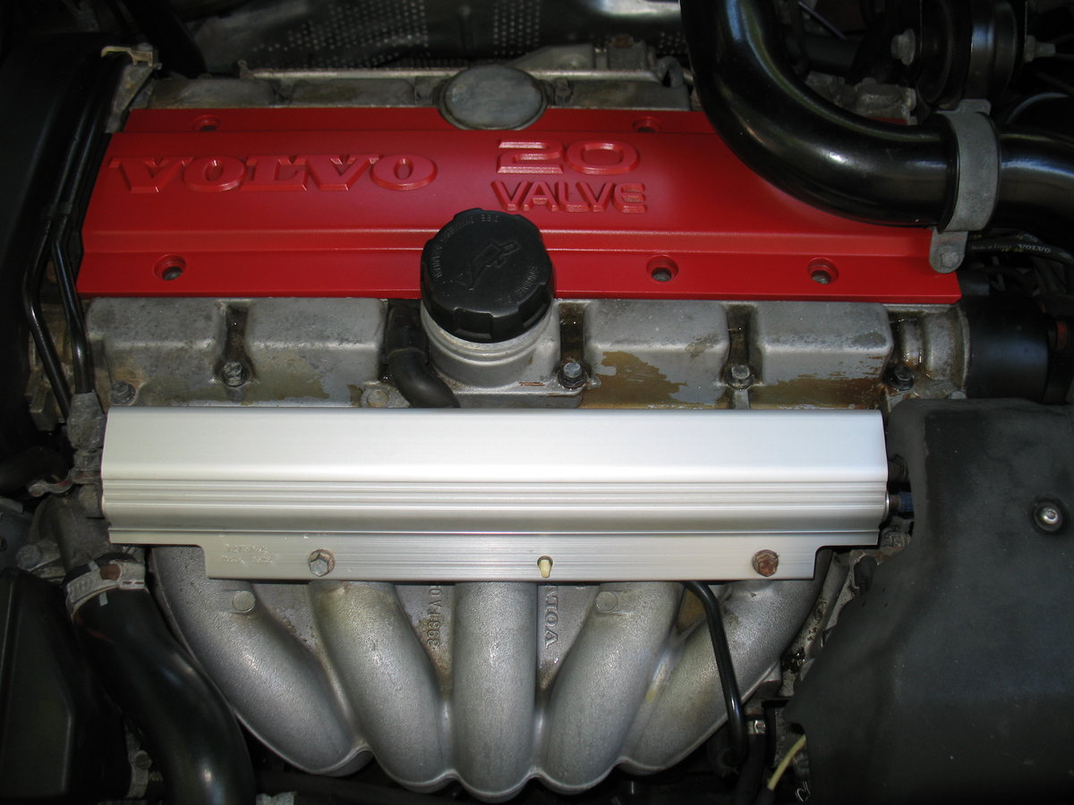

I picked up a can of cheap spray-on stuff at AutoZone and it did a great job. If it's really nasty, you may have to do it twice. I did it once, but used a toothbrush to scrub all the nooks & crannys and all the heavy build-up. It might be a good idea to cover the driveway with some soapy water under the car before you do this - it'll look like an oil spill when you hose it off!
To make it really look good afterwards, spray it down with a 50/50 mix of water & Armor All and let it air dry. Looks pretty sweet, especially the plastic and rubber.
I've also used A.A. sprayed onto a rag to scrub the rubber & plastic under the hood. It helps to remove the dirt/dust/oil buildup really well.
A few other things you can do to make it look even better:
- Paint the sparkplug cover with high-temp engine paint.
- Peel off the sealant from the fuel rail and engine block - The engine takes a little more effort so I'm still working on it, as you can see.
- Rub the aluminum heatshield on the firewall with a dry, clean rag to polish it up nicely.
Kind of hard to tell how improved it looks from these pics, but trust me - it sure doesn't look 14 years old!
