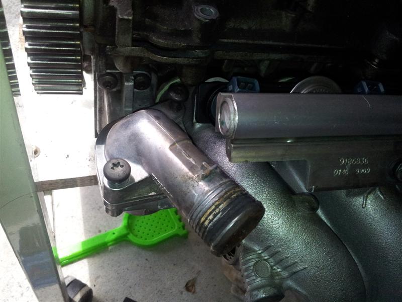

Matching square port intake gasket to 1999 NA intake manifold

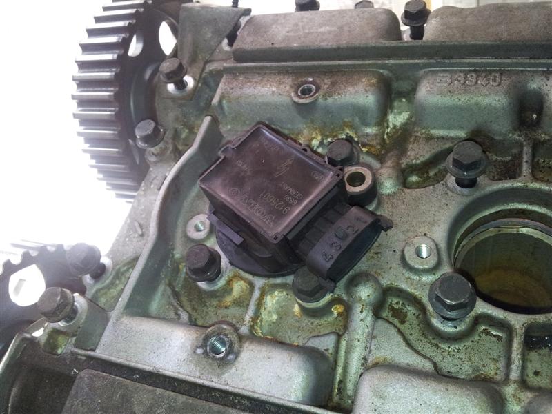

1999 Coil pack on square port head

1999 NA manifold on Oz 20 valve square port head
