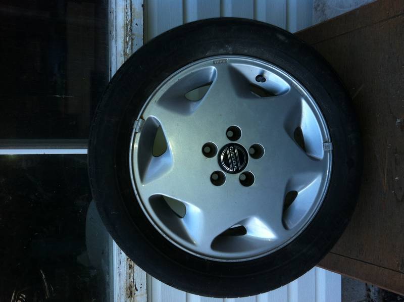

These are the rims. I looked on google to see if they are on any other volvos... I did not find any pics but found some more for sale with the newer emblems making me wonder if they were on newer volvos?

Different offset...they're going to stick quite a bit compared to the 850/v70 wheel.

Those are 1995 or later 960 wheels you have in photo and they do work. -> 1994 is a different offset on 960 and 1995-> is the 43 mm offset of the 800 platforms.

I google 940 not 960. lol.
I found a bunch of 1994 and up 960s with these rims on them... Can i be certain they will fit or is there some sort of measurement I should take when I look at them just to make sure they match the fit of my current rims.
