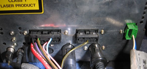

The easiest way to tell if the wrong connector made it to the back of the radio is to look.
The smaller of the 2 main connectors ("B") at the back of your stock HU would only have 1 wire.
That means that the back of your stock HU would have look something like this:
SC-901 rear - while connected sm.jpg (35.47 KiB) Viewed 3304 times
If the smaller black rectangular connector on the right is chock fulla wire,
and you're using the OEM Volvo amp RCA to DIN adapter cable that's the problem.
