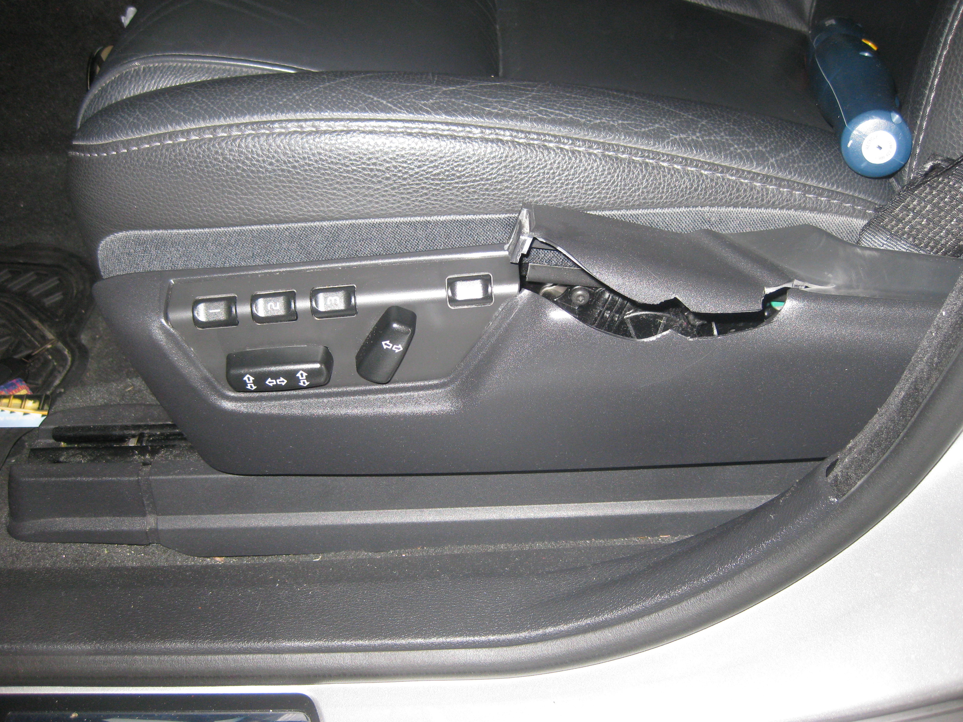

I just replaced the drivers side seat control panel on my 08 XC90 and thought a short might be helpful. I bought the part from VolvoPartsWebStore.com for $13.60 without shipping which was the cheapest I could find. I picked up a few other things to justify the shipping (oil filters, crush washers). I got the charcoal gray one which is part number 39802011. Other colors are available to match your interior. The new one has a couple of ribs on the underside to reinforce where it had cracked so I'm hoping this will last a lot longer, plus I plan to be a little more careful getting in and out.

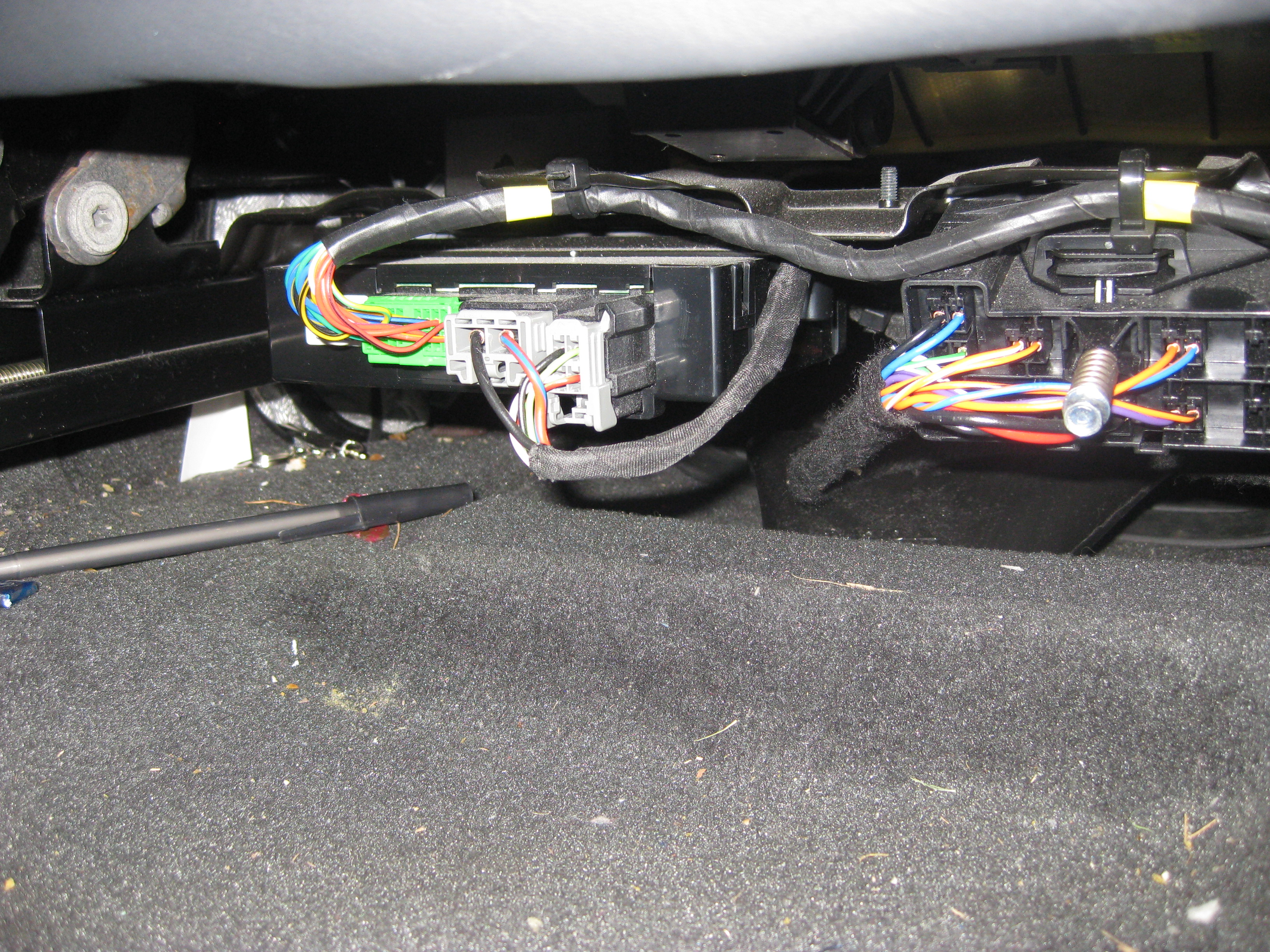

First, move the seat all the way back to get as much room to work with. If you look under the seat, you'll see the seat control cable running to the panel. The cable was marked with yellow tape to show where the zip ties were. Two were connected to the bottom of the seat and the third connected to the seat control panel. Cut the zip ties with the cutting pliers and you'll be able to remove the cable from the harness. Its the green one on the left. Squeeze the underside of the connector and it should come free.

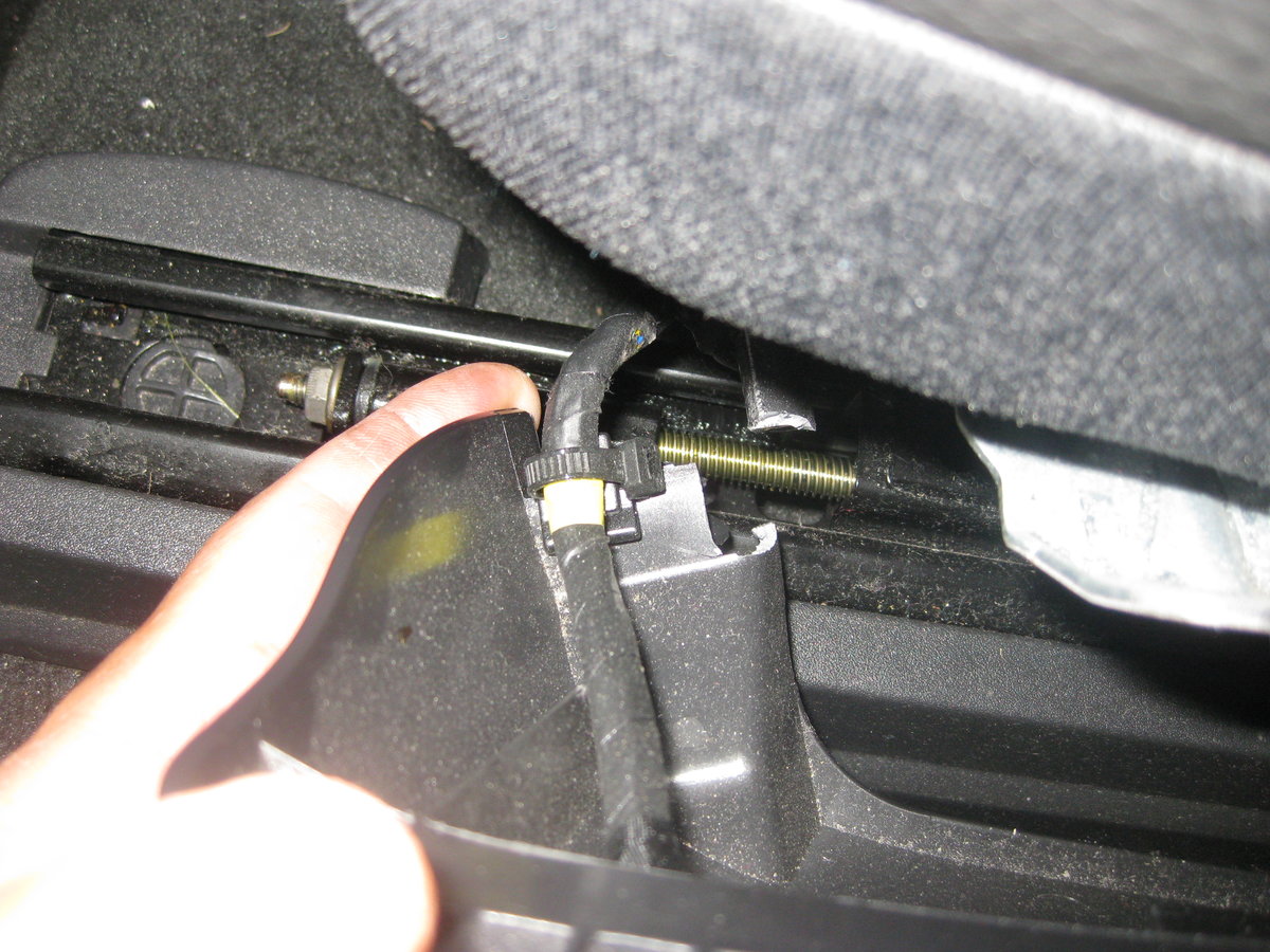

I cut all three zip ties, but in retrospect you only have to cut the two which connect the cable to the underside of the seat. The third one is connected to a small black plastic/metal clip which can be removed from the old panel and placed on the new one (It's near my fingernail, zip tie and all). The new one didn't come with this clip so you'll need it either way.
