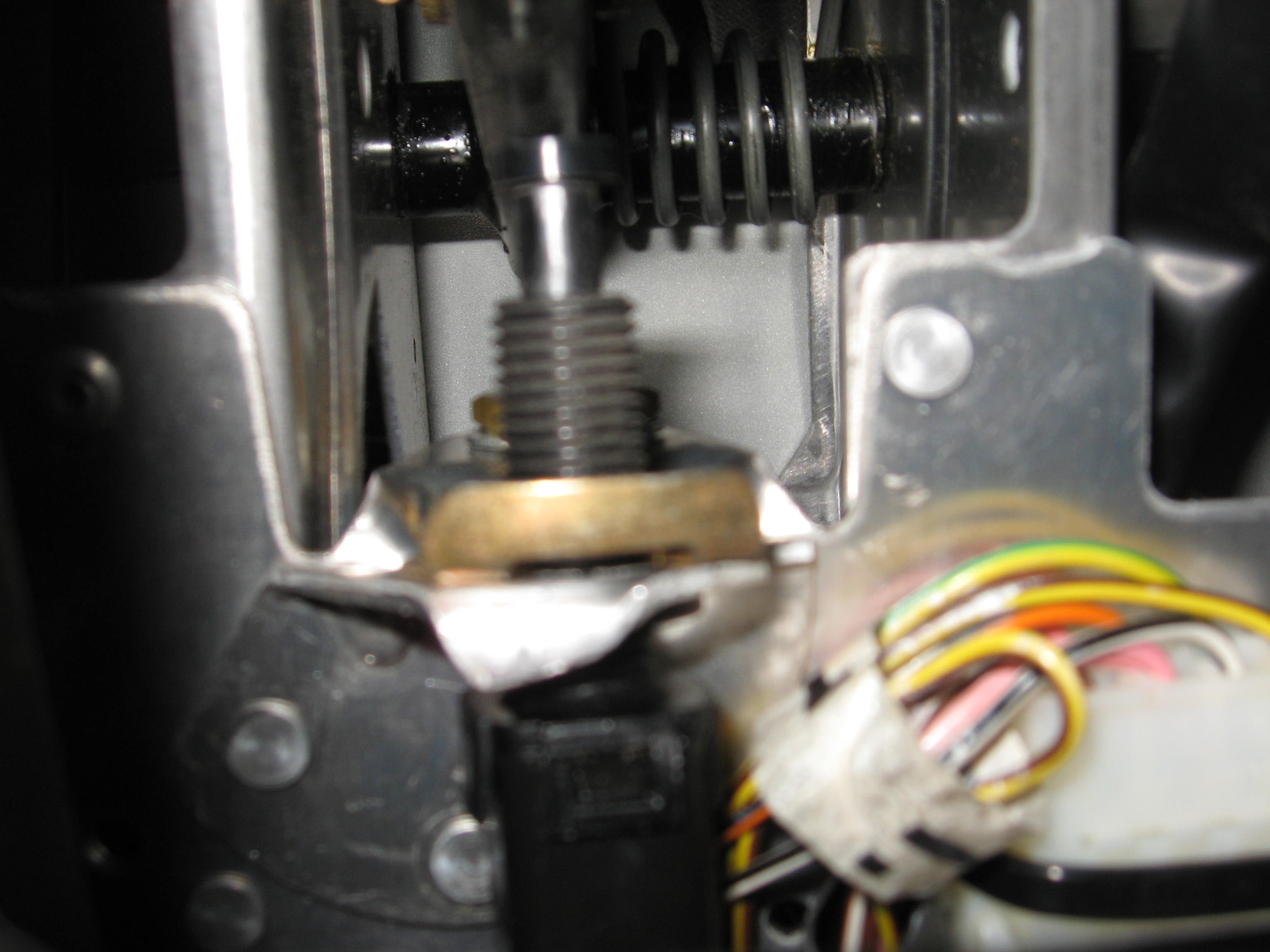

Any step by step on a home repair?

There is a spring type clip that holds it in place make sure it has not come off or stripped the threads on the switch assembly. I don't know S70's so I do not know if a cover panel may need to be removed for easier access. The cruise switch is pretty universal though.
bottom of photo is toward the driver
