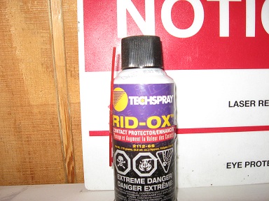

Also when I have to pull a connector or plug I always use the RID OX. Used it on the injector connectors, ECT and others gets rid of the oxidation and preserves a good connection. Pricey but to me worth it. Actually works.

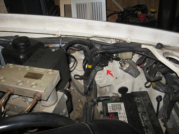

This is the picture(of the module) from the frugal mechanic website. I located it on the driver side forward of the ABS and OBD just above the battery.
