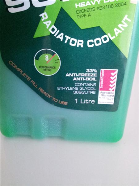

AVOID coolants like this one in the pic:
In metric speak 1 litre of coolant weighs approximately 1000 grams so this coolant in the pic is at 1/3 dilution, which should be avoided for all Volvos. If I added water at 50/50 to this stuff I would have very little coolant (around 15%) and this can cause the car to boil/overheat. Even at 33% most Volvos would find it hard not to boil over in warm/hot weather
For these Volvos you need a cooolant with 100% coolant in the bottle so roughly 1000g/ litre or if non-metric can somebody help out here????

cn90 wrote:precopster,
You are from Down Under, so 33% is good enough. "volvogirl75" lives in Houston and for the most part nice and hot. However, one never knows these cars are driven north in the winter. Therefore, in N. America, the recommendation is still 50-50 strength for coolant for N. American market.
cn90 Did you read my thread? The whole point of my long winded and perhaps confusing for some thread is that she may have inadvertently diluted her mixture to well below 30% or worse and is simply overheating as a result.
Volvo has never recommended 33% dilution for ANY market. I certainly wouldn't do it to my car regardless of the weather as the corrosion protection is simply far lower with weaker mixtures. I was trying to dissuade volvogirl75 from using this mixture. I'm certain it's obtainable in the USA but if you're not in the know you may be tempted to buy it.
BTW we had 109deg F last summer in Melbourne over three or four days. If this isn't hot I don't know what is!!
As nobody else has mentioned strength or otherwise of the coolant she may have used after the heater bypass thought it may be best to go back to basics. BTW a Volvo will boil in even mild weather at the wrong coolant concentration. Cooling fan comes on at 105deg C which is 4deg over boiling point. Is the cooling fan coming on? Does the car boil with a/c on? (cooling fan should be on with a/c)
Start with cheapest/easiest items: Coolant, thermostat, then check fan operation/fan relay
