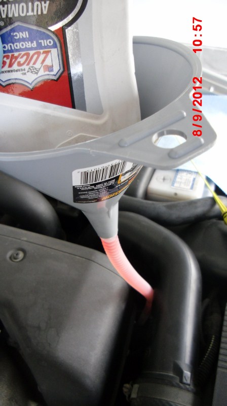

The O'Reilly brand Dexron VI is working fine after a few days and almost 200 miles of driving. Seems to be smoother shifts at low rpm's, but that could just be my imagination or just because there's new fluid in the mix. The old MaxLife ATF is compatible with Dexron VI according to Valvoline's website.

My car just hit 125,000 miles.
I am following the advice of MVS members and doing a follow-up because there's still old fluid in the torque converter and cooling lines that hasn't come out. Last ATF drain and fill was done on the 31st of Jul this year. The magnetic drain plug was a lot cleaner this time around, only wiped off a thin film of fluid versus the sticky gunk from last time.
I put in a container of this stuff based on web reviews and my local Volvo mechanic uses it. Now my transmission is filled with O'Reilly brand Dexron VI, Lucas ATF Conditioner, and leftover Valvoline MaxLife ATF. I said that a drain and fill with Dexron VI made little difference, well that was not the case with Lucas. It really does smooth the shifts! I can barely feel the change from 1st-2nd gear, which had a slight thump before. I've been driving it for a day and I love it. I didn't have any AT leaks so I can't testify about it's stop-leak ability.
On a side note, I only seem to drain/fill 3 quarts worth of ATF. I read that it's normally 3.5 quarts out of a total 8 quarts. Maybe it's the incline of my ramps. I measured on level ground and it's above the Cold mark after filling and below the Hot mark after driving.
