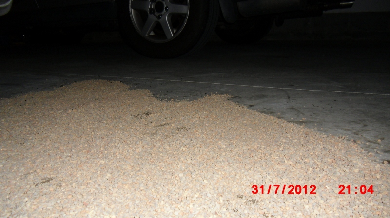

- Use kitty litter and/or absorbent filler to soak up spilled ATF.

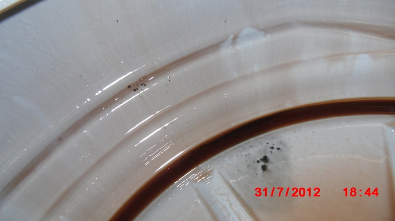

- There's a small amount of debris that came out with the old ATF.

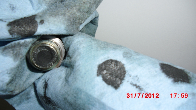

- The magnetic ATF drain plug had a lot of sticky gunk attached to it.

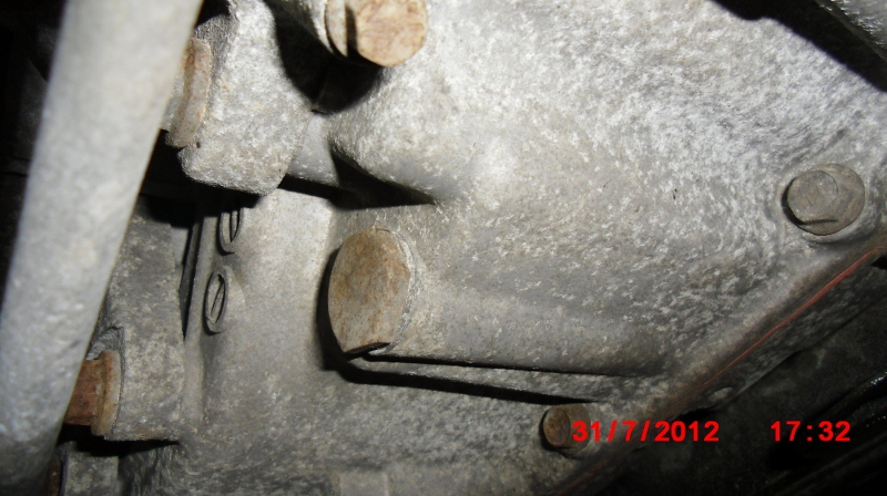

- ATF drain plug on the bottom right edge of the transmission case. Notice the crush washer, I re-used it.
