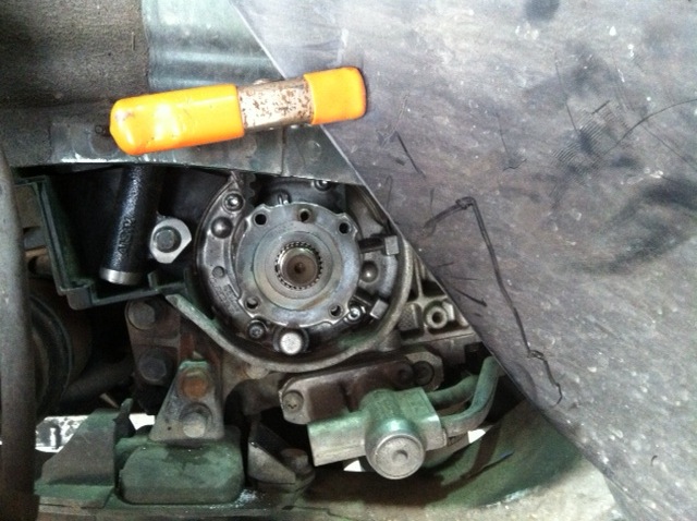

I linked up the Crank Shaft exactly. (took out plug to reduce pressure really helped)
Crank Shaft
Crank Shaft

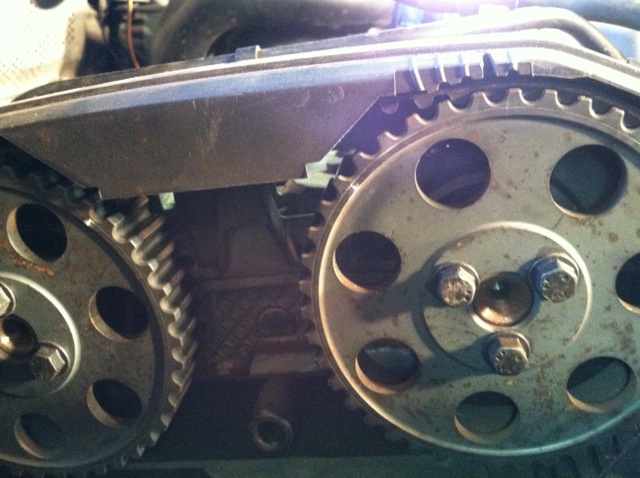

Now looking at the Exhaust and Intake. Notice exhaust is advanced. When I initially did this job, the exhaust rolled forward on me. I did roll it back a bit. Should I roll it back one more notch? Intake is lined up perfect. Tough tell from photo.
Cams
Cams
Thanks, Ben

be sure to put the mark on oil pump exactly in the middle of the correct valley first. I think the top looks fine. if you turn crank back a bit these marks will be right on.
99 V70XC 158K
95 850glt 188K
