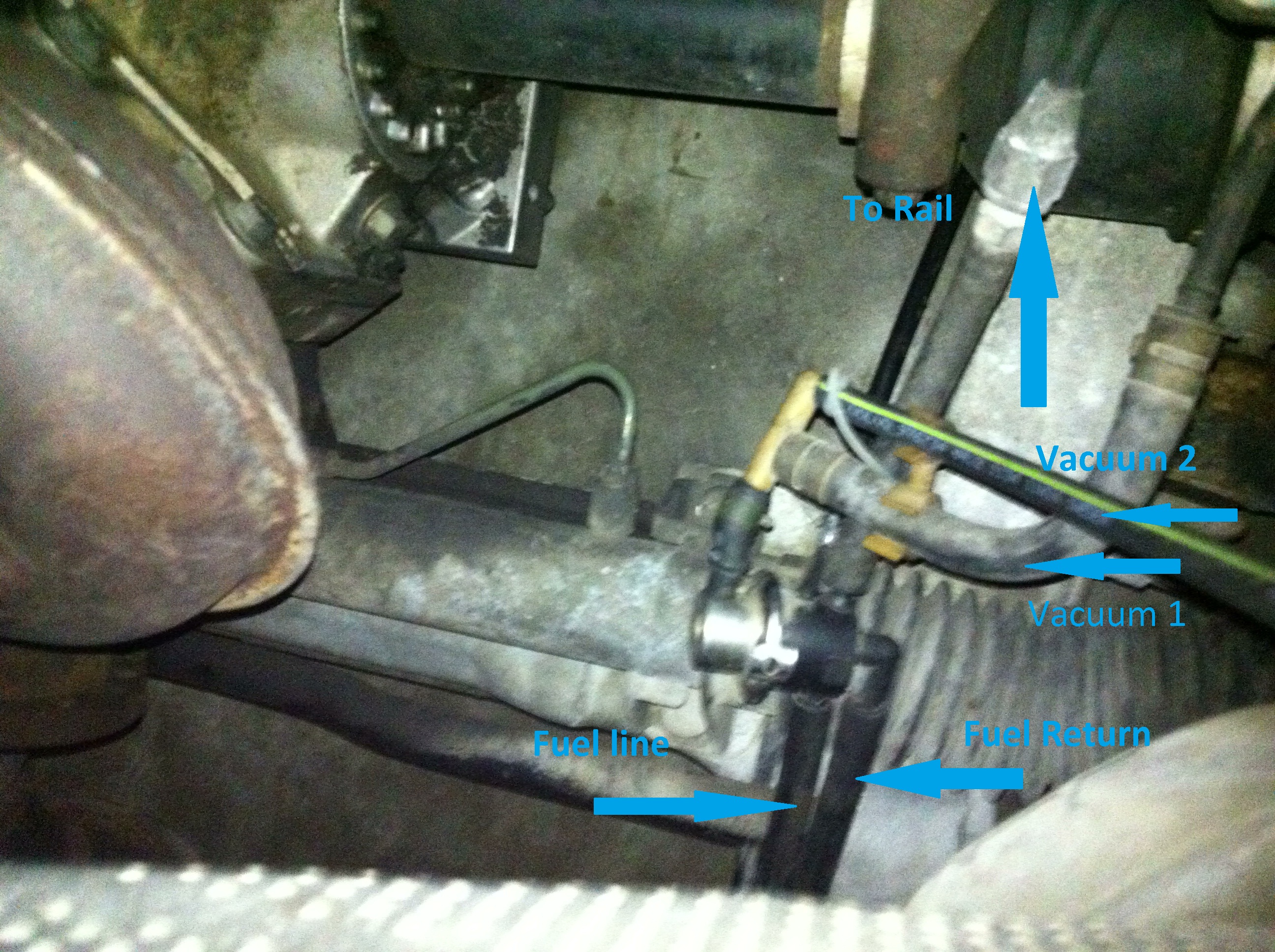

Easy way to tell?
Do you have these TWO fuel lines on your engine?
'98 S70 T5

Post by Felix_saenz »
I have two lines coming across the valve cover, but one is the fuel supply and the other is vacuum line 1 in the picture, it runs to the intake manifold.

Post by jimmy57 »
I agree it's deadheading. The integral relief valve on the pump is limiting it to the mid-90's fuel pressure.
Take the FPR out of the vessel on the line and check to see if the return line is free.
