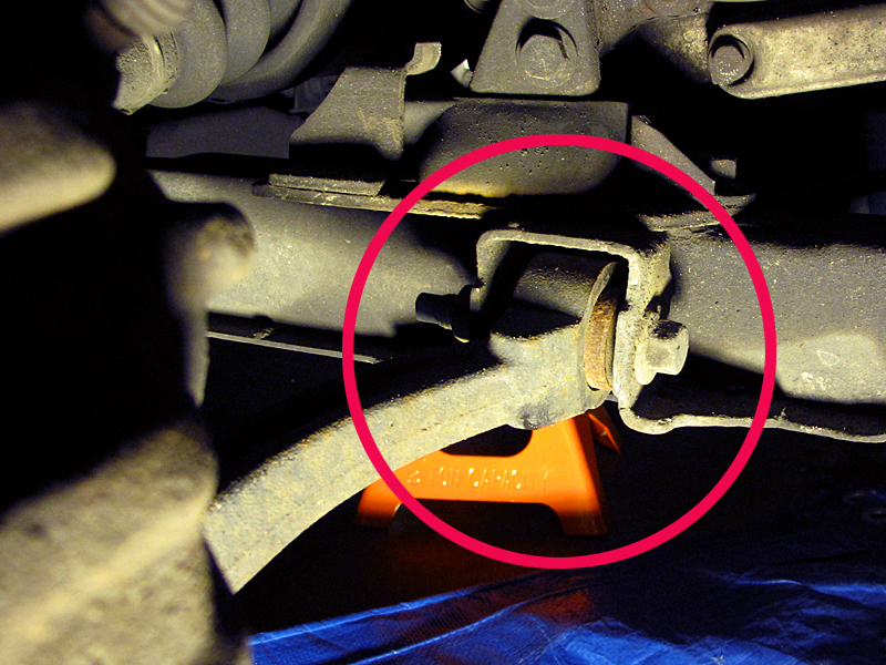

FWD wishbone with 3 bolts. Picture showing 1 bolted to subframe.
'97-850, driver's side control arm bolted on to subframe
