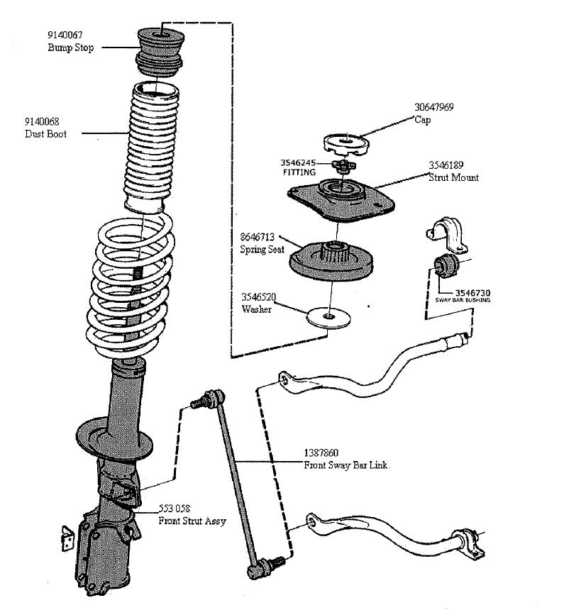

I'm unfamiliar with the S40, but here is a picture of the parts you would need for a 850 strut. A lot of people buy XC90 spring seats because they are stronger. At this point I would replace all parts such as tower bearing (strut mount), bump stop, boot and all the hardware of course. Like precopster said, FCP is a great place to shop for this stuff.

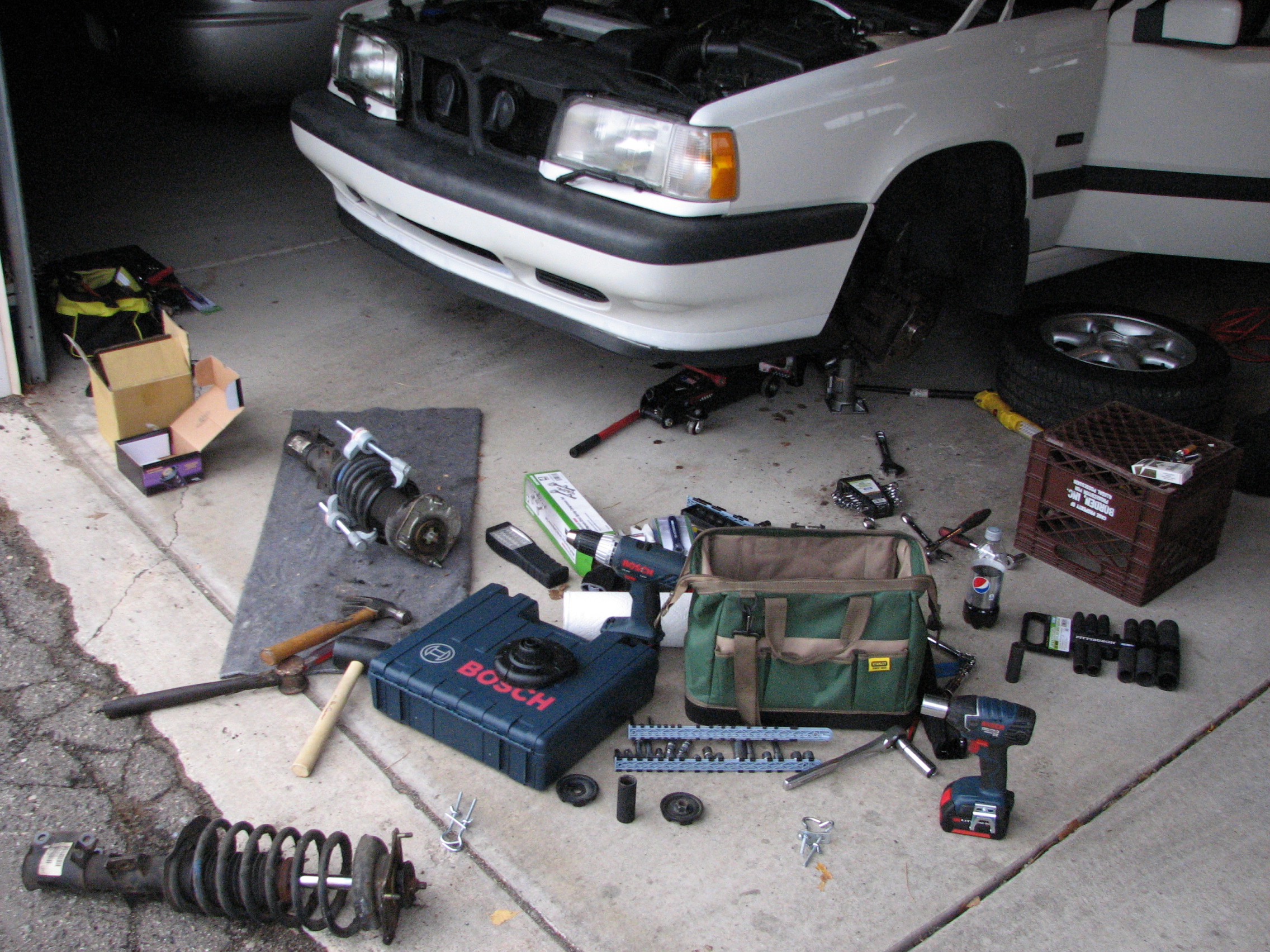

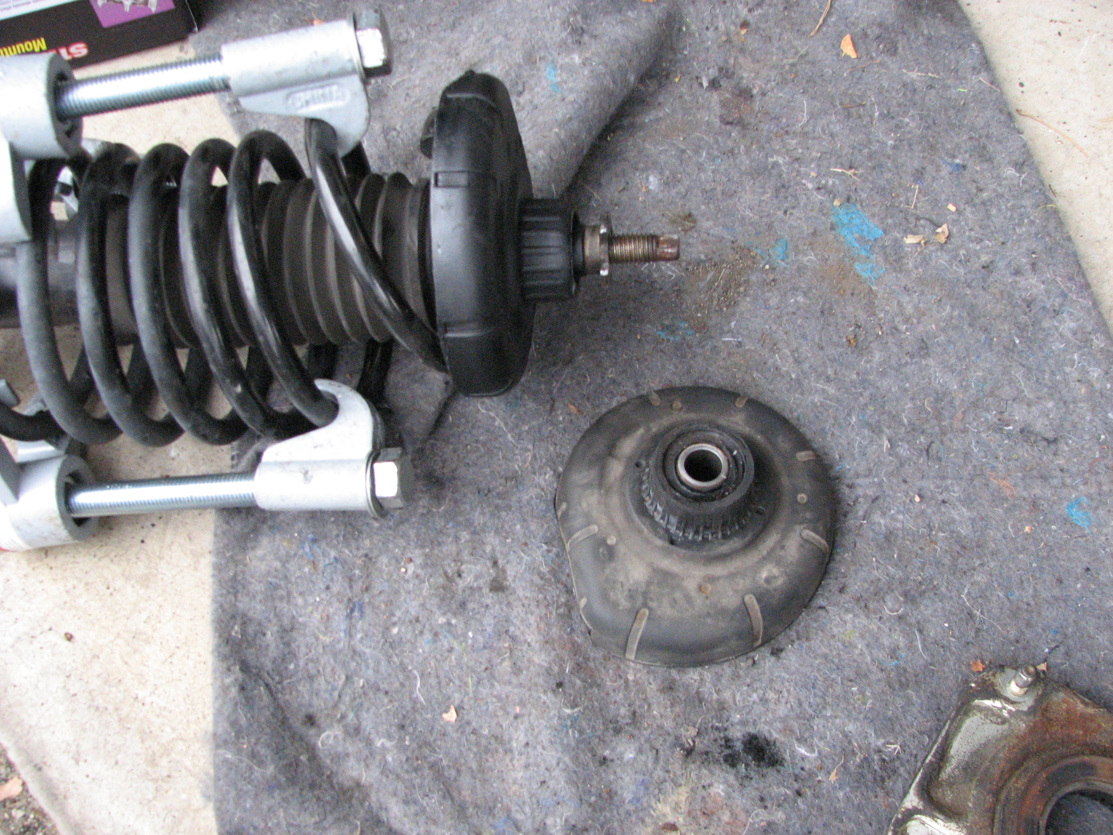

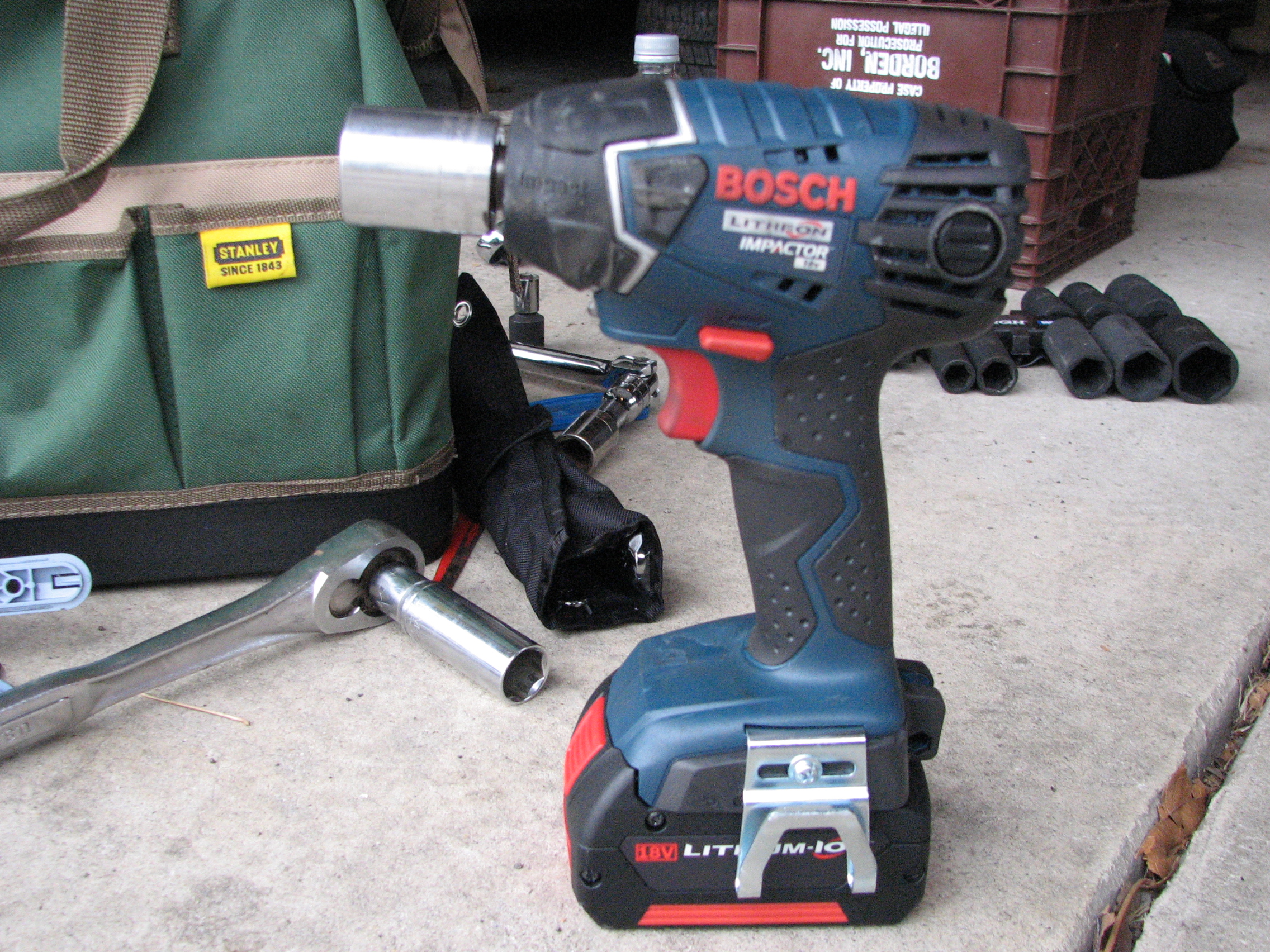

I had replaced the spring seats last year which was absolutely needed. I came across a great deal on a set of OEM Sachs currently awaiting nicer weather for my installation.
Receiving the Bosch 1/2 drive impact wrench was a pleasure for the second strut as I did it all manually for the first. I am actually looking forward to compressing the springs after having developed an easy method. As far as spring compressors, I purchased two sets of the "stick" type. I use three of the four on each spring for safety.
