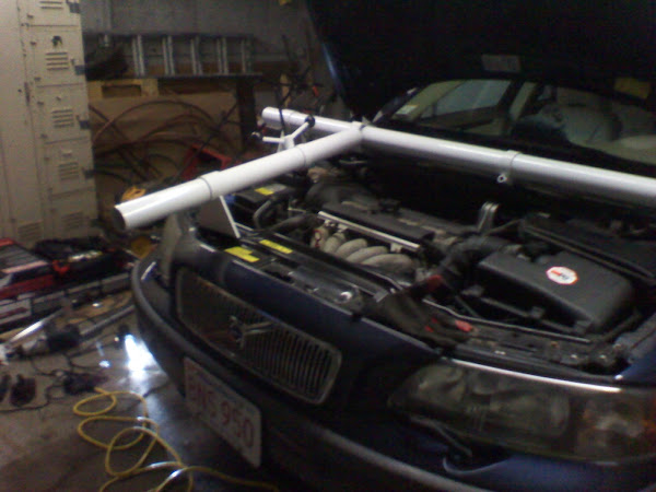

You want engine support bar. I was able to replace front pad on N/A engine w/o removing intake manifold, there was enough clearance for ratchet extensions and joints. Probably won't work on turbo. Make sure you've got all the gaskets. Don't remember anything particularly difficult for average DIYer, with good support bar it is quite doable.
Here it goes:
Here it goes:
