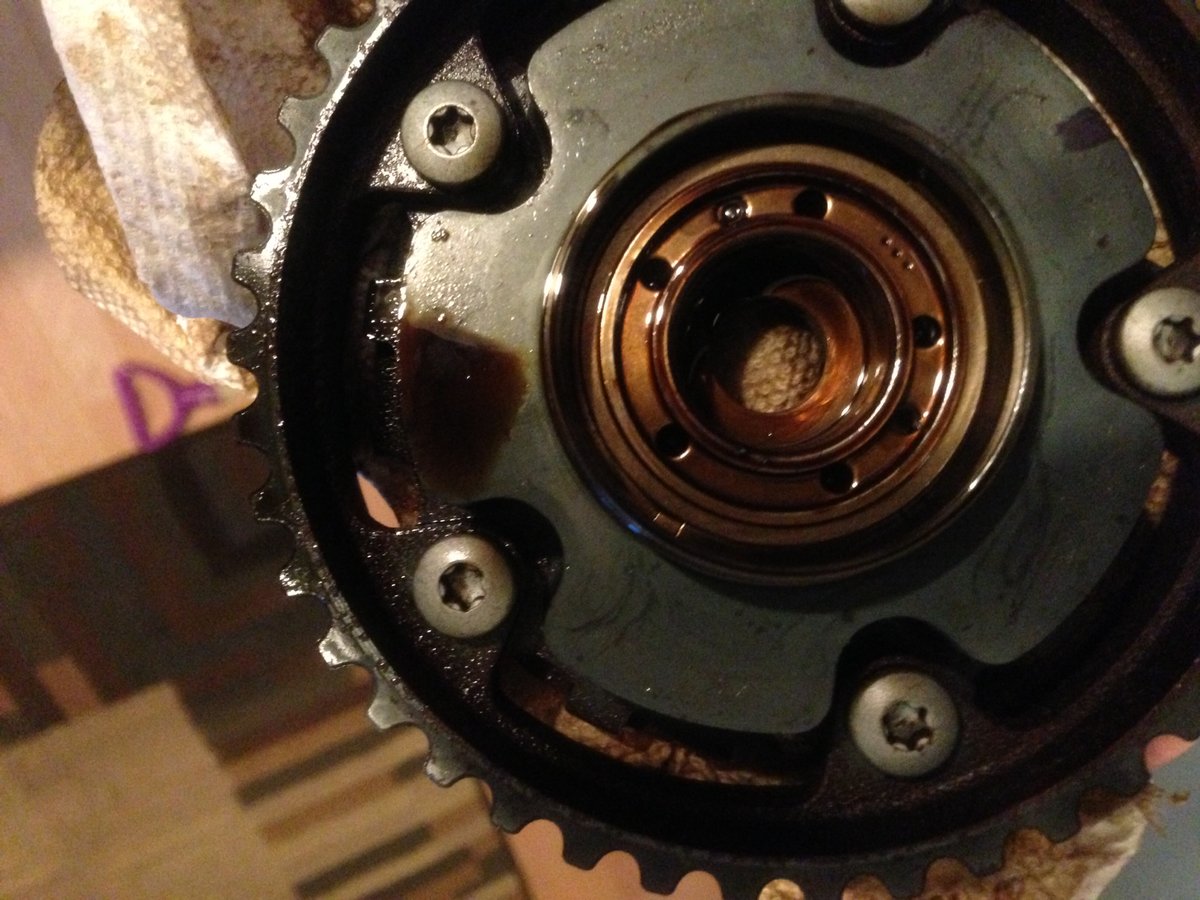

I now have the gear off to find the leak. Problem is that I don't know which (seal vs gear) is causing the problem. The seal looks good.
I know the leak is coming from seal/gear because oil fans out from below it, covering the timing belt and timing tensioner. I posted pictures up to see if anyone can spot the issue.
Here is the cam seal: and here is the cam gear: Any help is appreciated. Thank you.

replace the seal ($4 victor reinz from rockauto), clean the VVT and run it . I am bothered by the seal being dry 360 degrees around. Makes me think its the VVT but I can't see the surface the seal rides on in your pictures yet so its not time to judge.
Make sure the VVT is completely clean on the seal surface. ( no residue etc)

I was surprised the seal looked as clean as it did when I pulled the gear off.
The surface where the seal rides has a film of oil and looked smooth. I'll take another look at it tonight and look for any blemishes.
