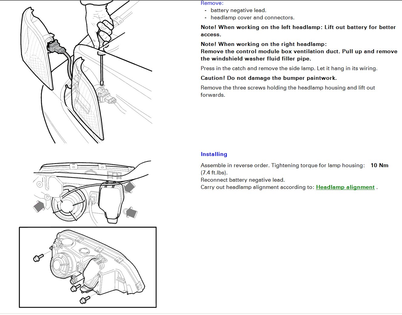

Post by BEJinFbk »
anjill182 wrote:Remove the whole assembly then remove the metal clips!
Absolutely! When I changed mine, the first step was removing both headlights.
Popping the clips on the bench was a piece of cake once they were out.
And I left the lamp covers in place and just unplugged the
connector for the entire headlight assembly. Much simpler.
And absolutely, positively resist the urge to touch ANYTHING behind the lens.
Oils from your hands will fry the lamps and the front coated silvering on the
reflector is extremely delicate and will scratch if you even breathe hard on it .
The cheap, Scancrap E-code lense's that I installed came with a long piece of rubber
to replace the complete "loop" of the original sealing gasket. Keep the original...
The other one will leave a gap, allowing moisture into the headlight.
Like you read above, this shouldn't take more than an hour.
