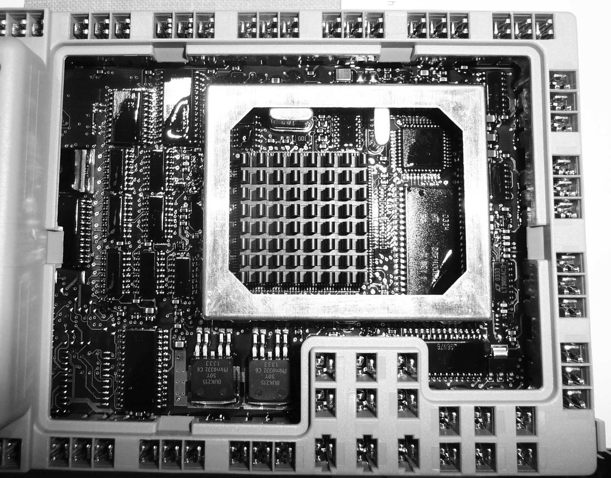

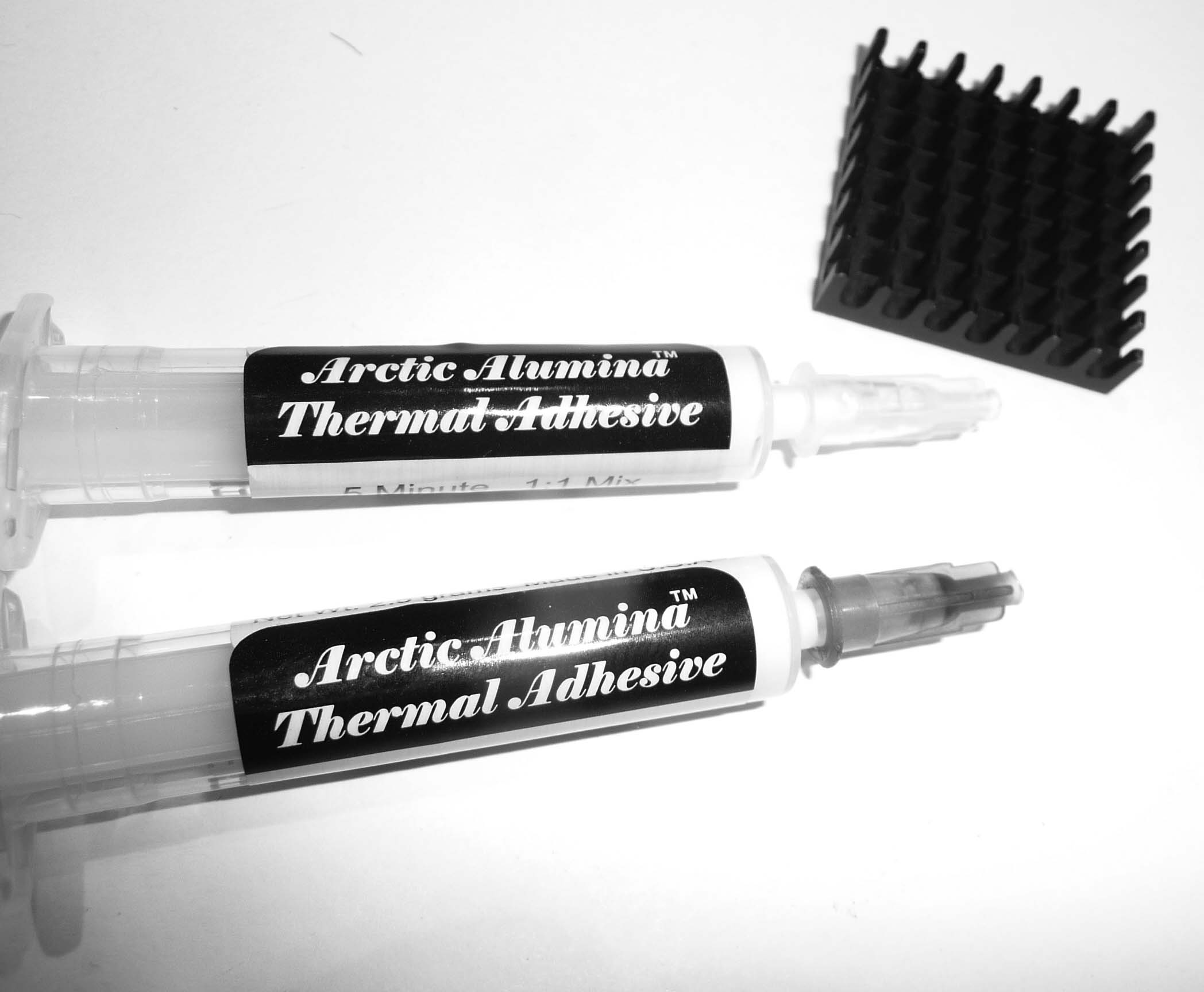

I really think that the problem was with CEM. My Volvo was working flawlessly in the cold or mild weather, and the problem only surfaced on hot days. Before it happened I heard clicking noises under the left side of the steering column.I suspected that CEM was overheateing and going crazy. I pulled it out, checked for rust, water sings in the wire harness and terminals and installed as big as possible heatsink on the big Motorola chip to keep this piece of electronics cooler. It is working so far. I drove 600 miles in about 90+ temperature weather, and those symptoms have not yet returned.
