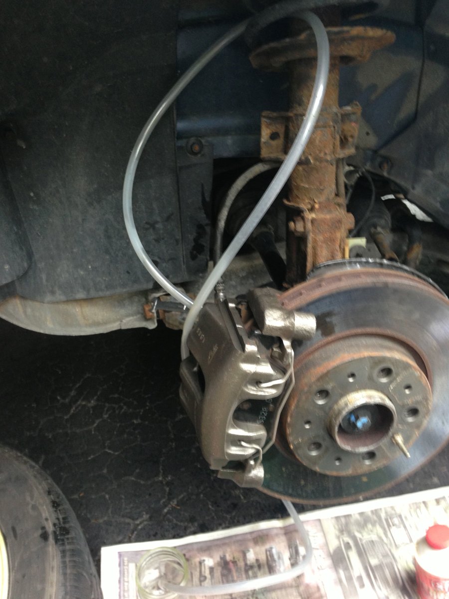

Bleeder on caliper was 10mm, original 11 mm - note loop in hose to keep bleeder wet - I ran about 250 mL of brake fluid through new caliper and found brakes were great after this. Pressure bleeding system after having it open is highly recommended.

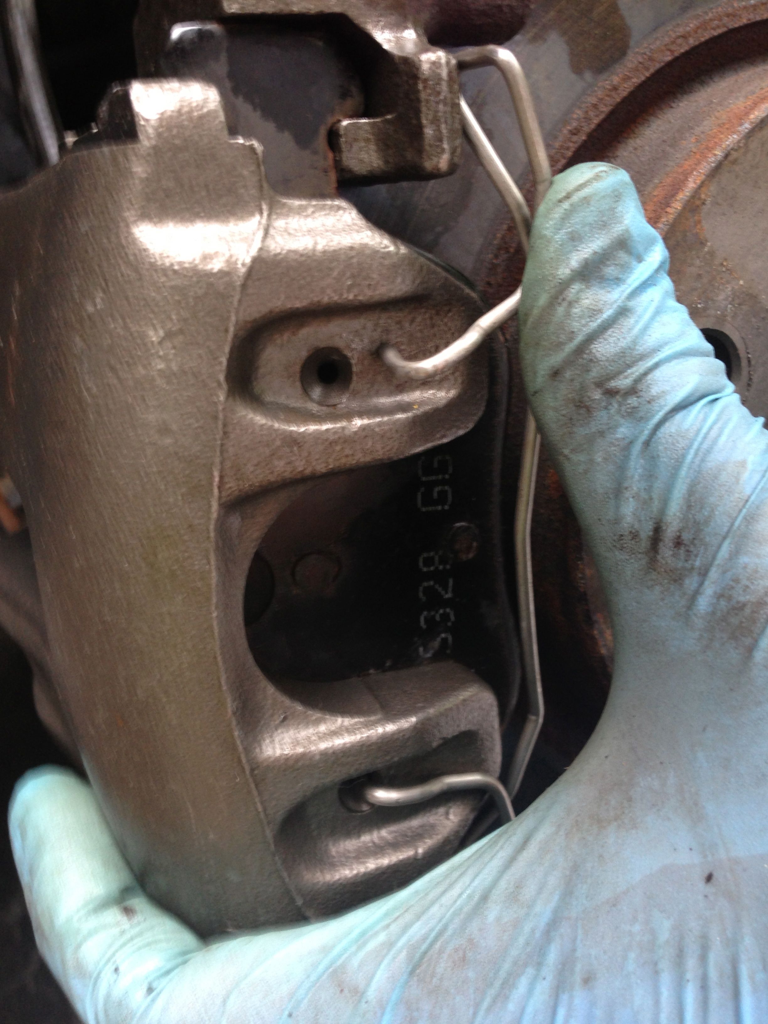

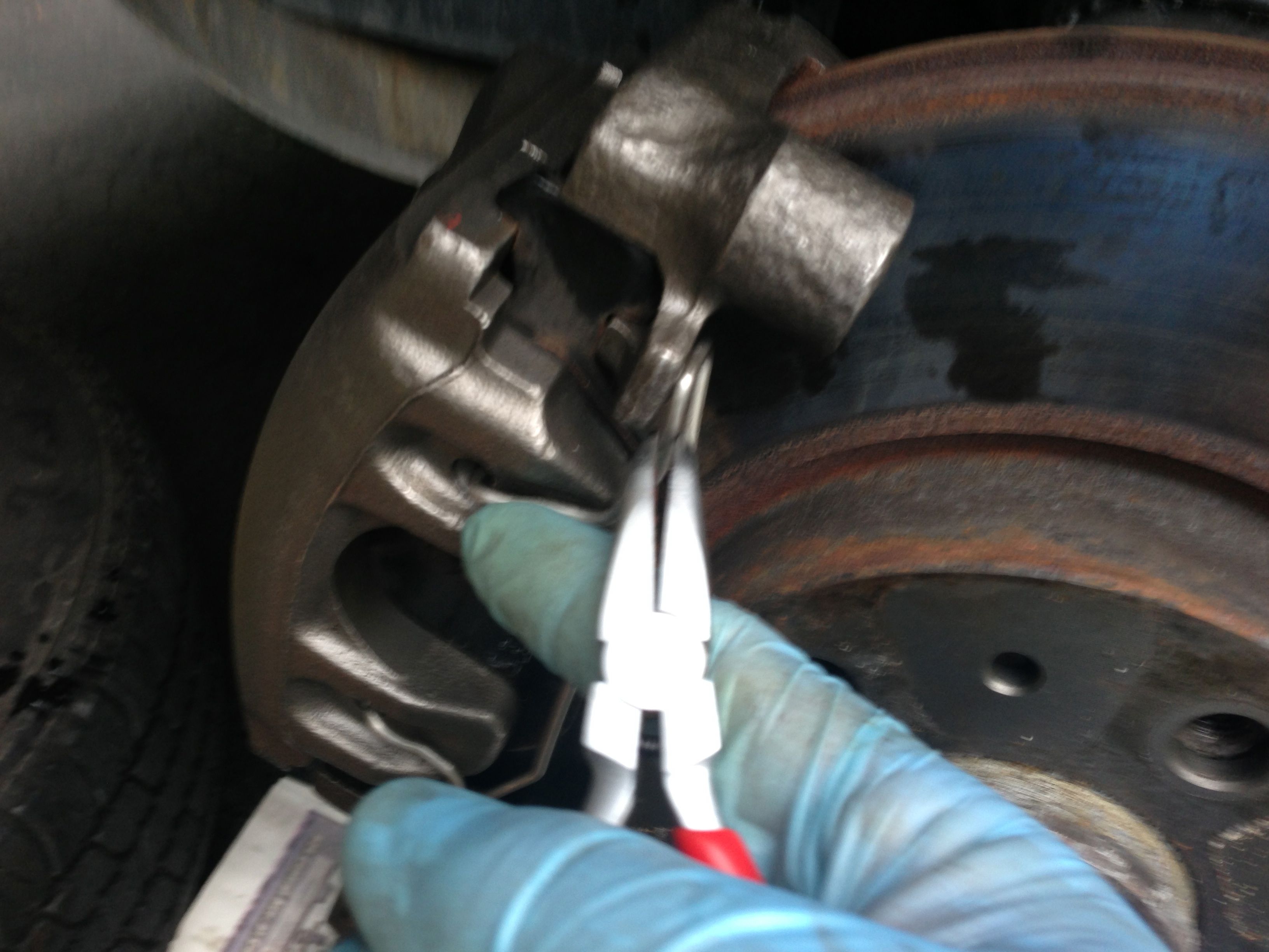

Reinstall spring - thumb pressure where index finger is, pliers pull loop down to push up on pad
Load spring into position...

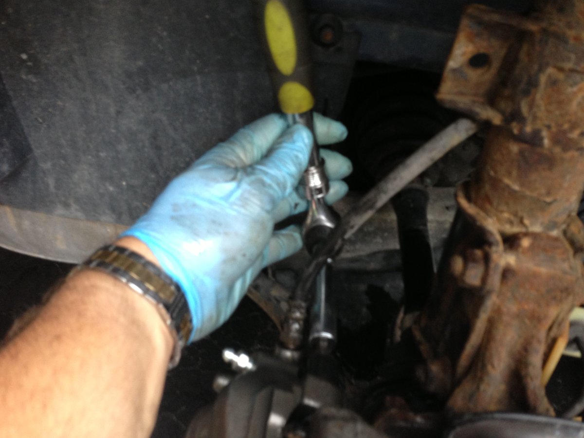

Start brake hose carefully by hand, spin caliper to hand tight, then about 3/4 turn on flare thread with 14 mm open end

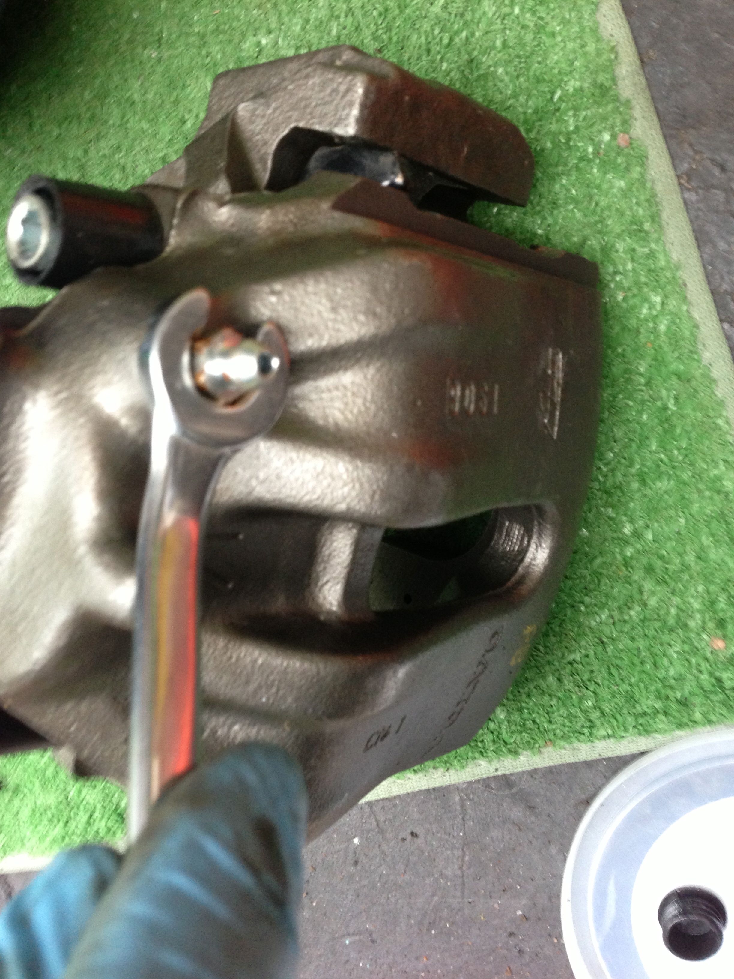

New bleed screw was 10mm, old one 11mm

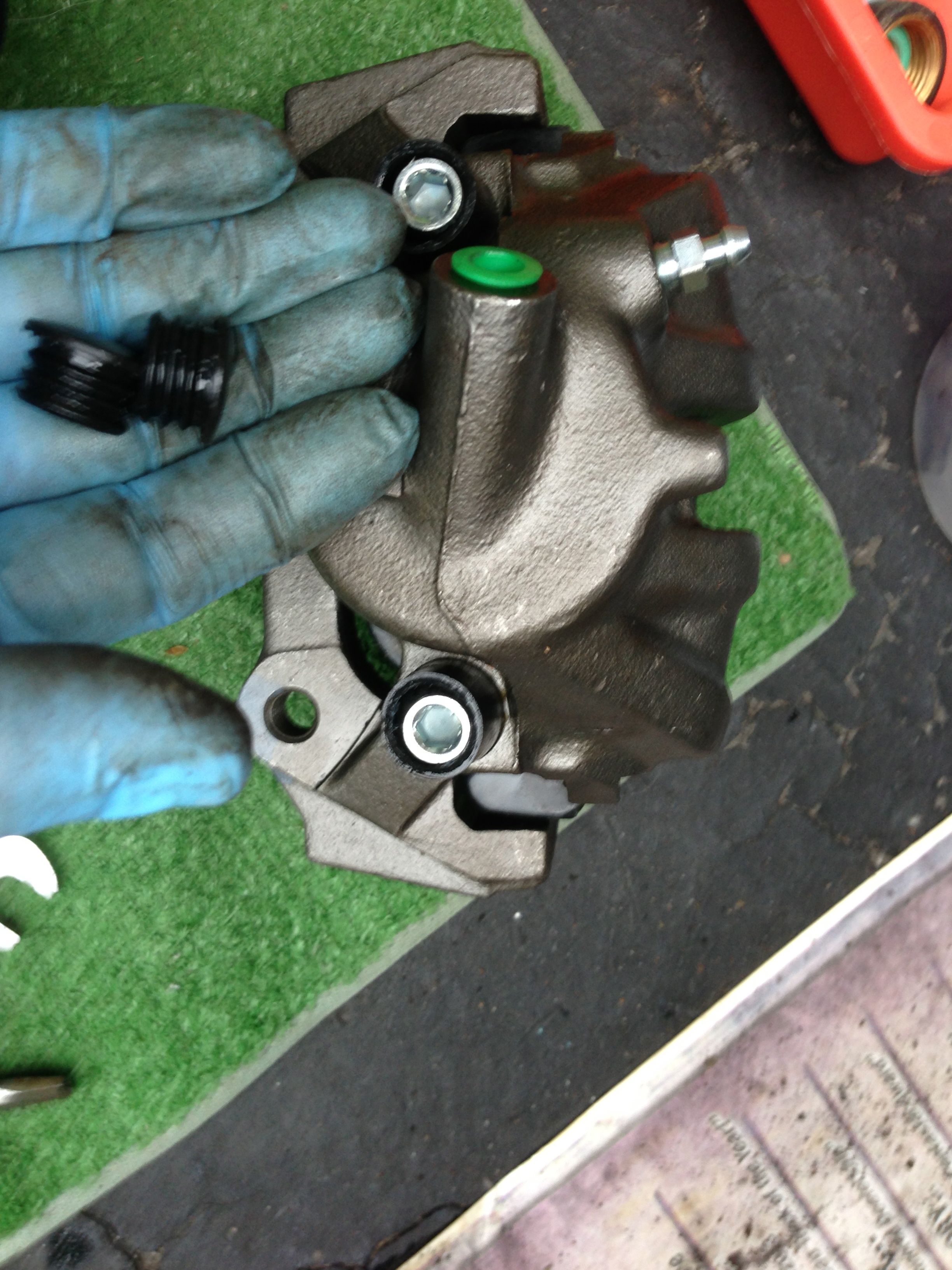

Top view of caliper in carrier - green is hose connection, silver new bleed screw, and shiny new greased caliper pins!

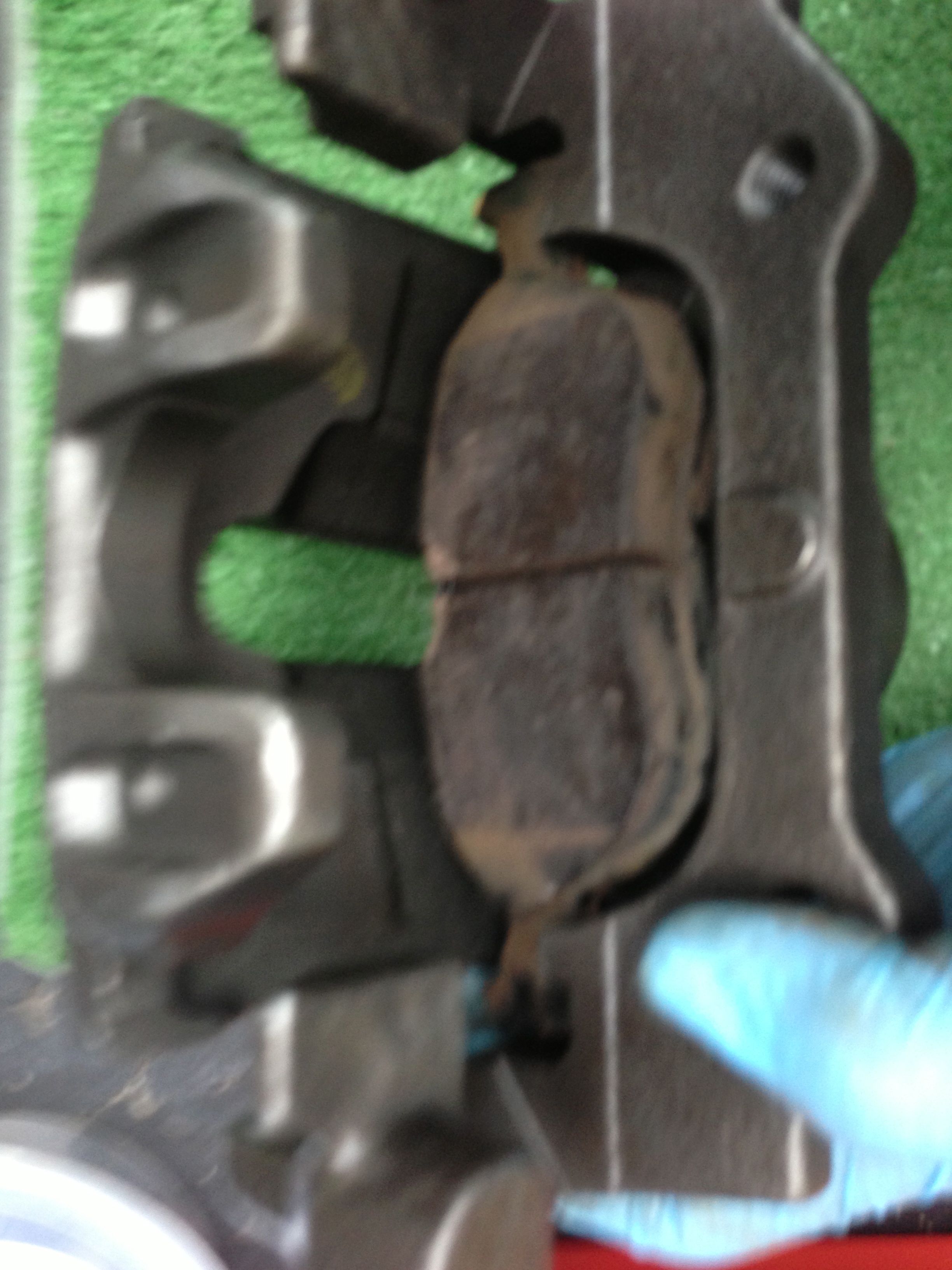

Load inboard pad into piston, use screwdriver to push springs in to slip into piston recess - sorry, hard to photo with two hands

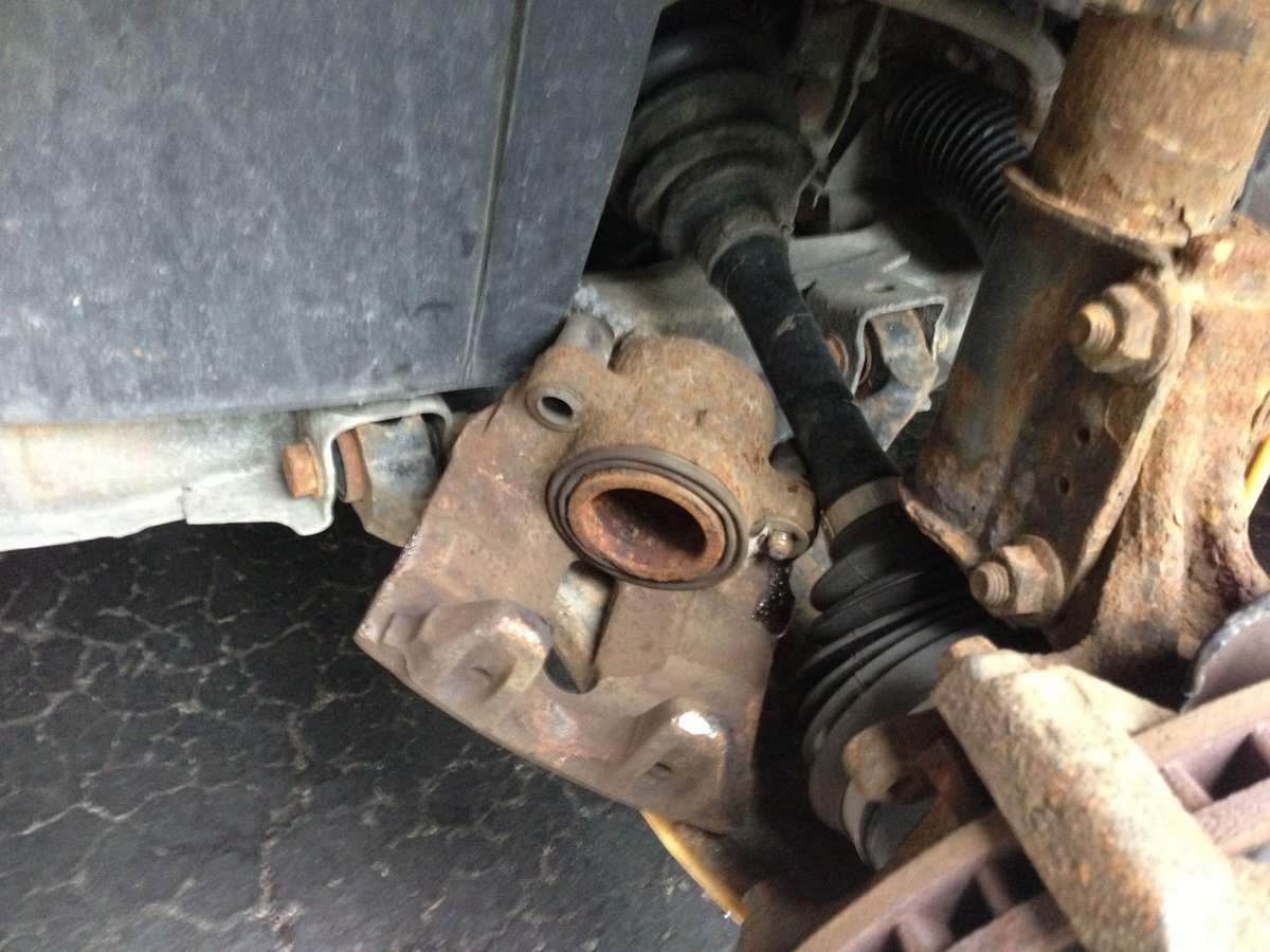

Caliper off - rest it on control arm - do not hang by brake hose!

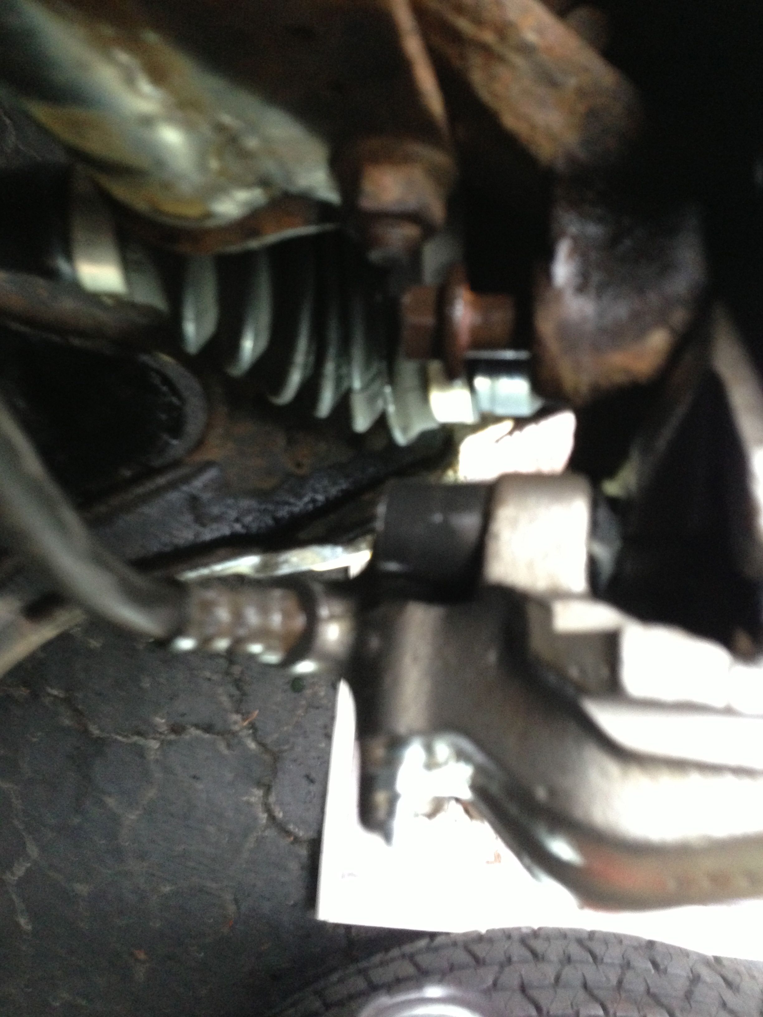

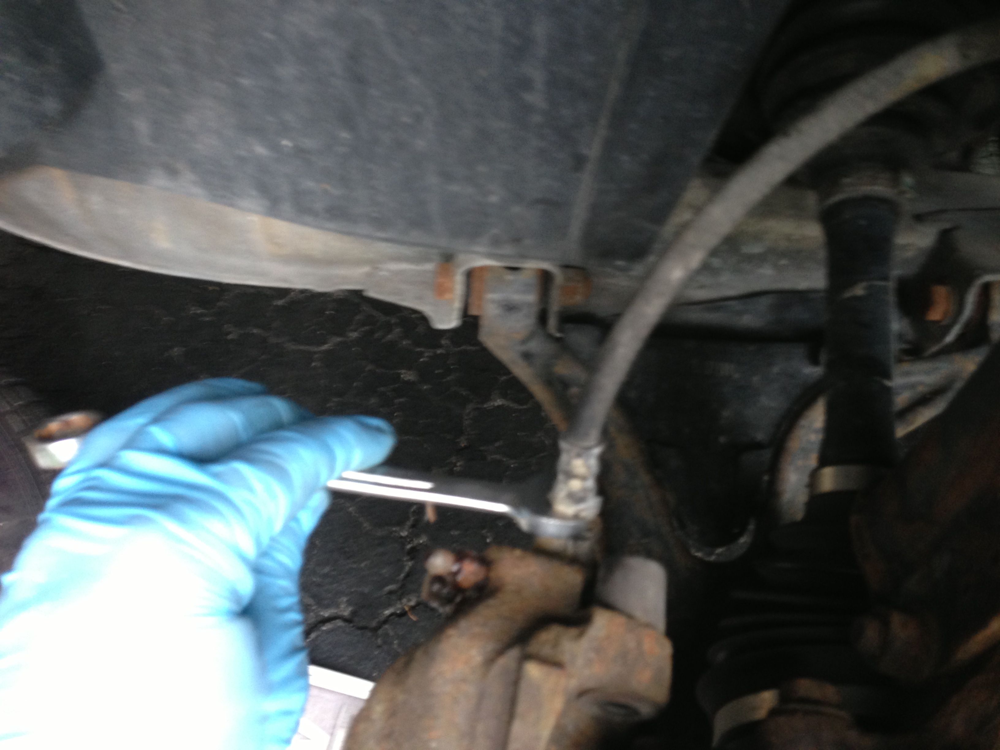

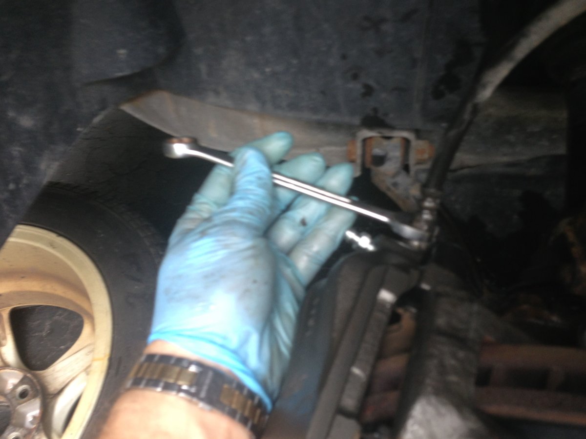

Slacken (just crack) brake hose with 14mm open end. You will spin the caliper off by hand later once it is off the rotor

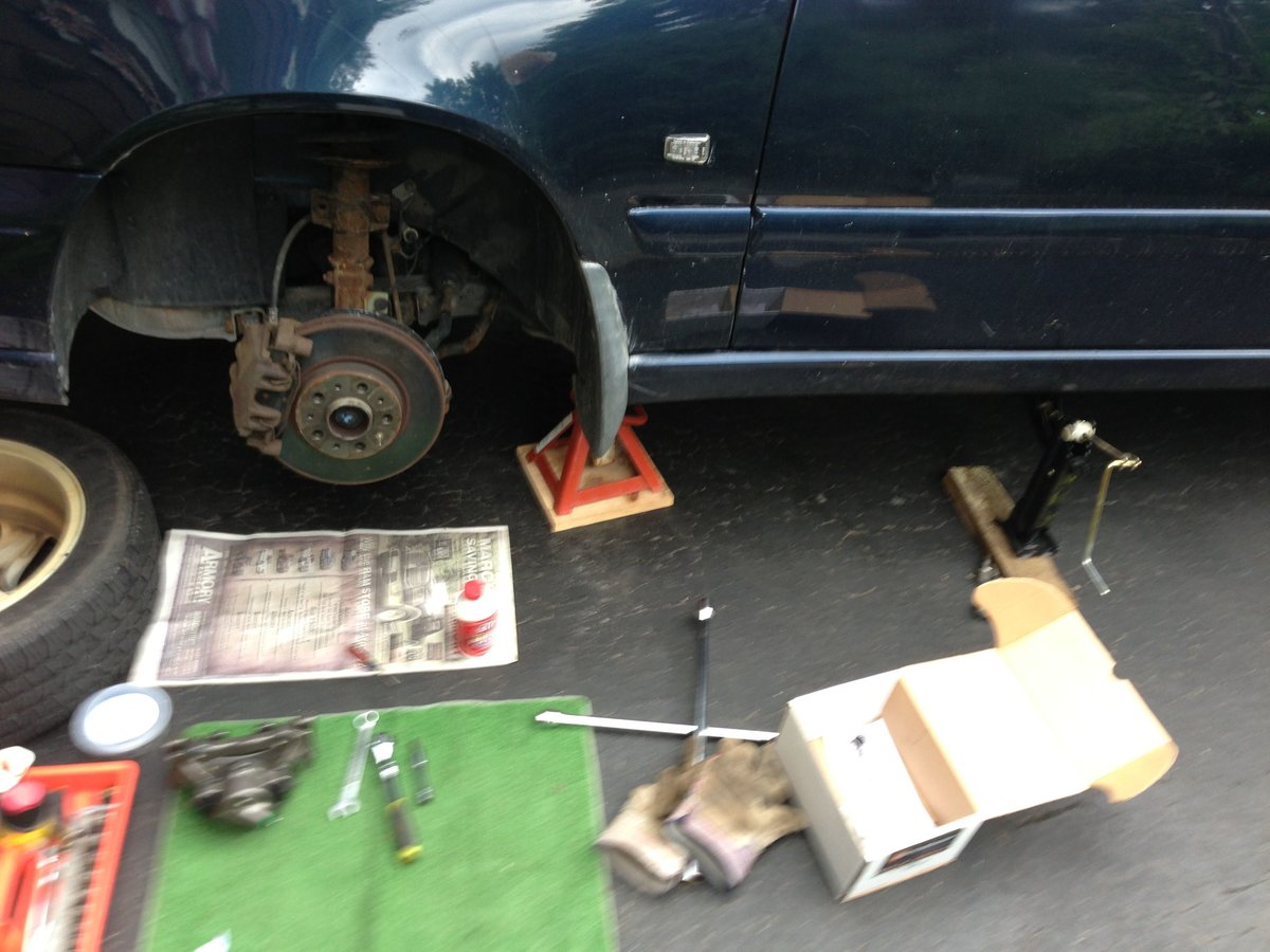

Ready??
Ready??

It's pretty easy to move it (14mm) while the caliper is firmly attached to the wheel - I've found once you remove it that job gets nasty.
I did leave out the pin removal picture, will edit

There’s a slight subtle point here I should have explained better.
The caliper hose is attached hard to the caliper and then to the flexible hose attached to a bracket. The hose/hard line connection is the tough one to break, so what I do is crack the line at the caliperwhile mounted, unmount the caliper, then unscrew the hose by turning the caliper. If the hose is in good condition this saves a lot of hard work.
