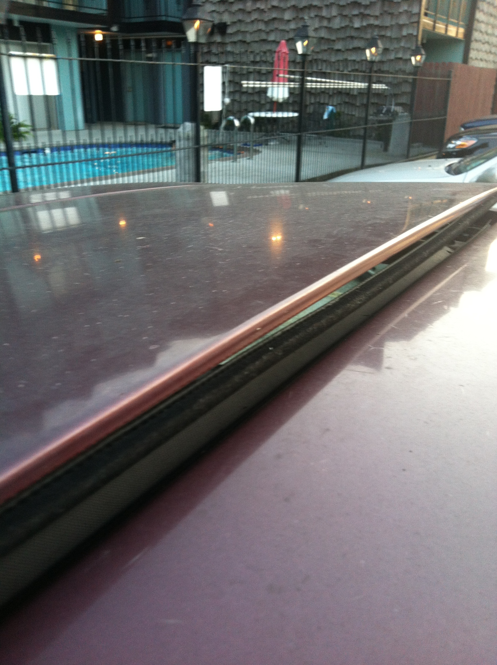

Hello friends,
I am going to work on my 740 this Sunday, need to glue this sagging seal for the sunroof. What kind of glue should I use? Any recommendations?
Thanks...

After proper cleaning and prep.
Camie 303 or automotive goop are the only ones I know that can take the heat. I think goop would be easier.

Thank you very much, just ordered goop off ebay...
