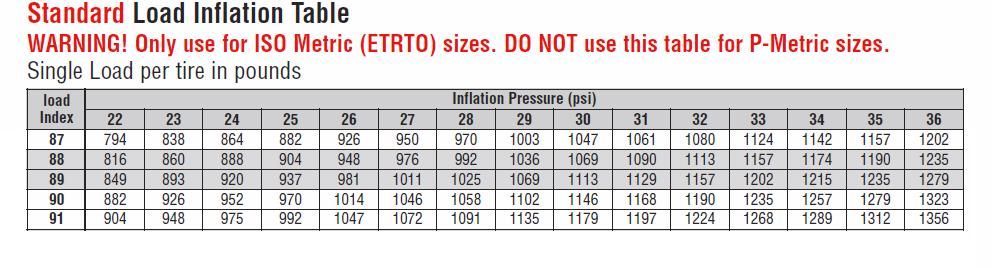

Here's where it gets even more interesting. Volvo's recomendations appear to be based on 205/50R16 tires, not the 205/55R16's installed after the great Wheel Bending Tire Recall Fiasco (my emphasis). The old 205/50R16's are usually a load rating of 87. The new 205/55R16's are usually a load rating of 91.
Using the above load table (borrowed from Toyo) shows that a 31 psi load rating 91 tire can carry almost the same load as a 36 psi load rating 87 tire - 1197 lb vs 1202 lb. Therefore, even using the seemingly low USA F34/R31 pressures with load rating 91 tires allows a greater overall load than the stockers at F36/R36!
I have experimented as low as F31/R28 cold with my 205/55R16's, with no apparent loss of handling, and a much, much more pleasant ride. Keep in mind that with only me in the car, the rear load is nowhere near the 28 psi/1091 lb rating on these tires as the weight distribution is typical FWD poor. The sedans were around 60/40 F/R split, so each rear tire might have 700 lb on it with only a driver.
