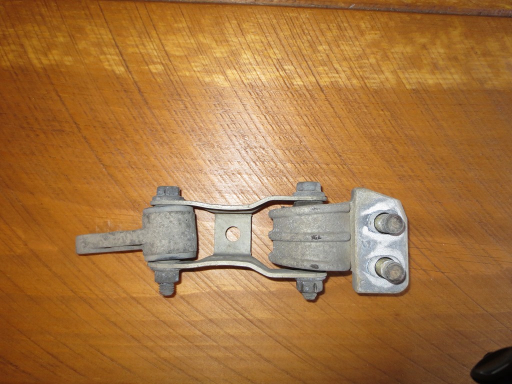

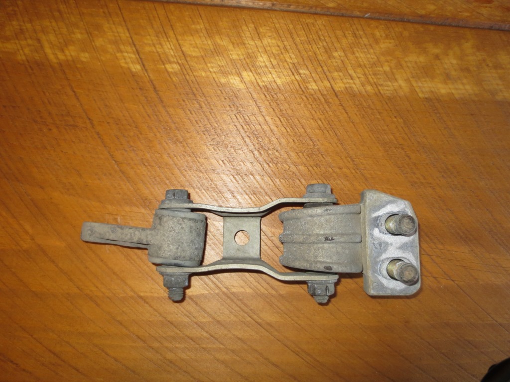

I checked the gearbox torque link and there was a lot of movement. In fact the smaller front one was completely shot.
I bought replacements for top and bottom. £60 ish from Braydon Motors for the pair.
Replaced them this morning and only driven a short distance but seems quieter. I think I can hear a clunk but maybe just listening for it. I will let you know.
I have attached pictures of the lower link to show how much movement there was. The top engine mount had cracked more than I first thought.
Thanks again to MVS and people who commented.
Derek
