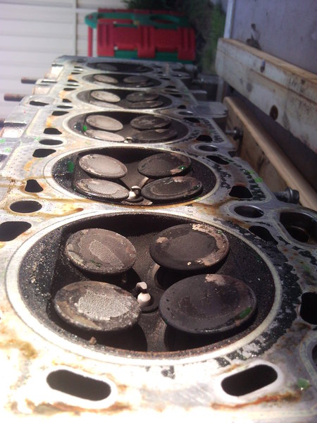

When you pulled the head off were valves seated in their seats or were there gaps. A simple test is to fill the combustion chamber with gas/fuel and test for leaks.

i just received the head back froim the machine shop. i did a light test to make sure they were all seated. i will go back over the Vida procedure.

yes, it is exactly like the picture you sent me. it is a straight camlock so i may be off ever so slightly, but i am giving it another shot. the only valve going down in question is #3 on intake. but the piston is going down, so i don't think it is a problem.
