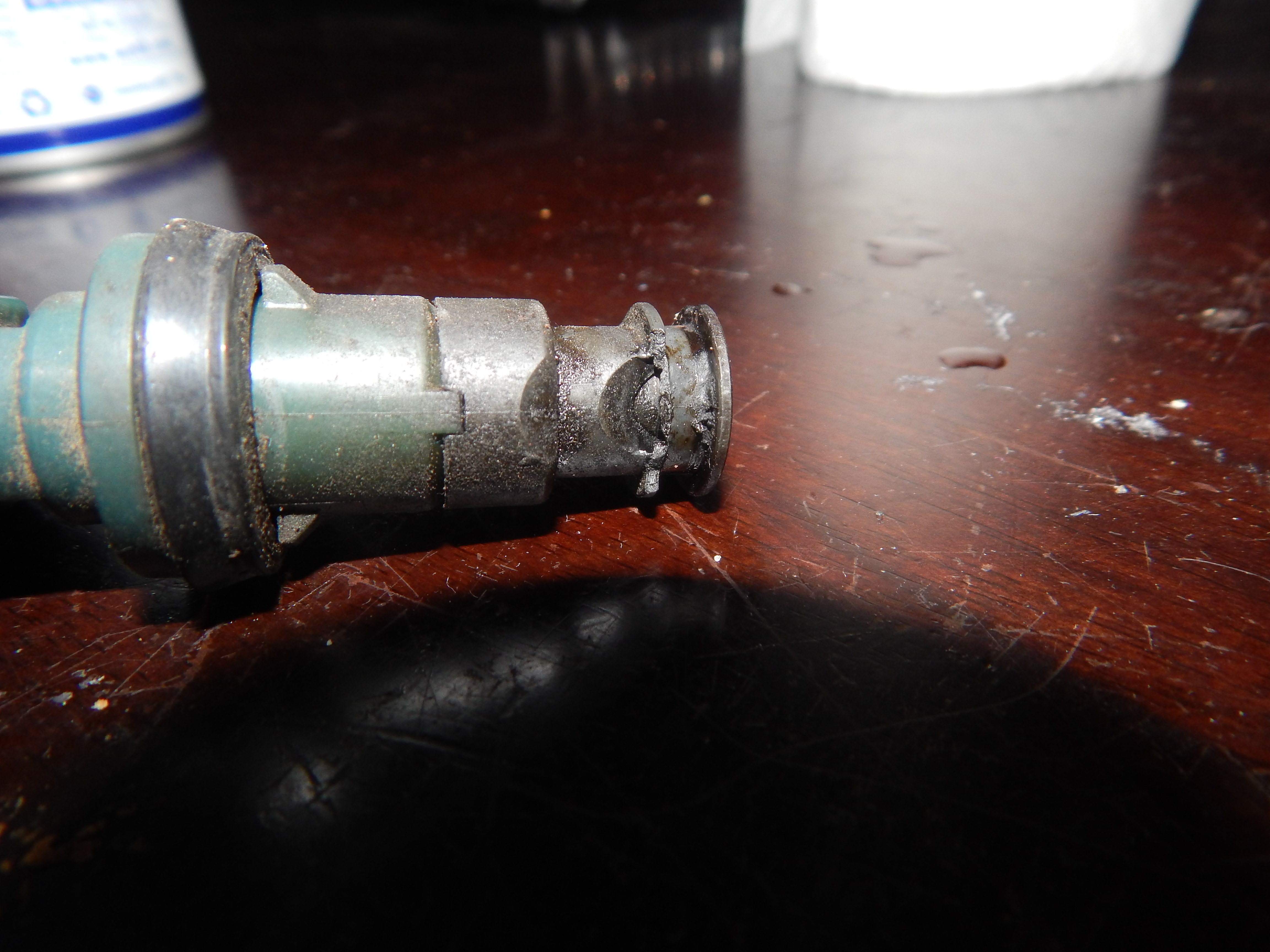

Aaalright. Checked everything last night. Lower o-rings and seals are good. Bought more o-rings and put those on. Good. Thanks for those great pics, Mike.
Here's a pic of my slightly broken injector. O'reilly dude said i should be fine though.
So concluding, i am pretty sure that is not where my vac leak is. Damnit. Lol. Thanks anyway dasapir :)
I will check those lines you pointed out, Mike. Thanks for your help.
