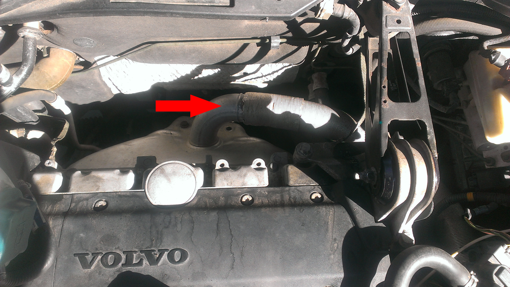

I recently have been searching for a vacuum leak, so i lifted the airbox off and sprayed my carb cleaner to check there. I noticed this hose came off when i took the air box, and now i am wondering if this WAS the cause for my vacuum leak.
Could this be a cause?
It wont fit back together tightly, so could i just wrap it up w/ some electrical tape?

That line is not under vacuum, the seal does not need to be tight. The corrugated hose channels hot air to the intake on cold startup. FYI electrical tape there would just melt and burn up, the exhaust manifold is under that metal shield and it gets very very hot.

+1, No need to worry about that one.
