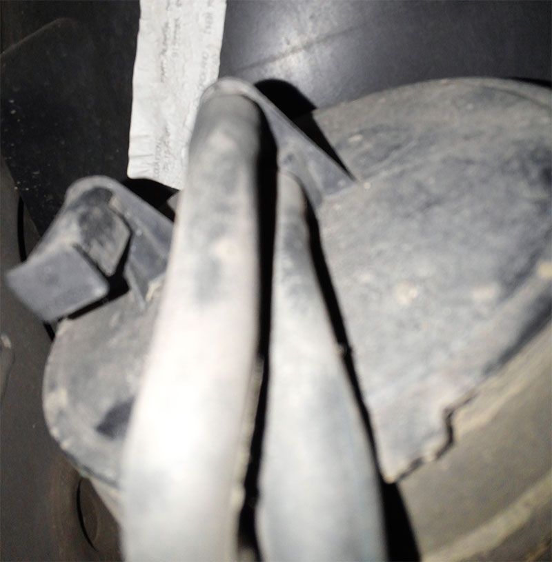

I found that these two hoses were in extremely good shape, with no leaks. In fact, they are in TOO GOOD a shape, when compared to the rest of the original hoses on the car. Why? Somebody has obviously replaced them trying to tackle this problem before. I'm guessing it was the previous owner and/or mechanic or maybe even the dealer. I also found a new looking zip tie holding the two plastic hoses leading up to the canister together; more evidence that the previous owner had someone under there trying to find the cause of the poor mileage/error codes. Here is a photo of the top of the canister, for anyone else wondering what it looks like:
So I've got good (new) hoses from the intake manifold, to the evap canister purge valve, to the canister, and out the other side of the canister to what I'm assuming is the fuel tank. No cracked hoses.

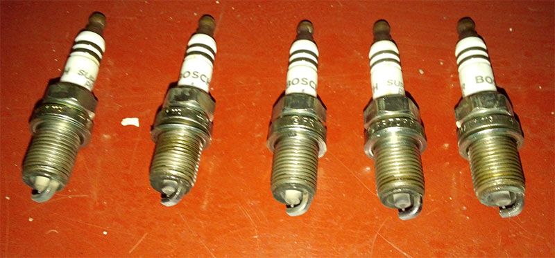

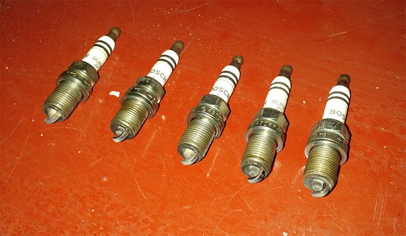

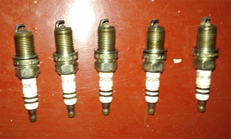

Next up, I took the advice of a board member and checked the plugs for any obvious differences due to a possible leaky injector. This was suspect, because the fuel system did not seem to have any pressure in it when I changed the fuel filter, hinting at a leak somewhere in the system. I pulled all five plugs tonight, and to the naked eye, they look pretty much the same. Here are a few photos:

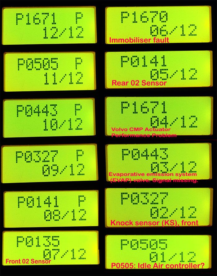

It is not the error codes in particular that bother me; it is the fact that the error codes are accompanied by SYMPTOMS (bad fuel economy) that hint to me that the error codes are in some way accurate.

Your plugs are fine.

By the way I think those 1670 codes are ETM codes not immobiliser

Sorry the 1670 is immobiliser and 1671 CMP actuator.
I had a feeling a knock sensor code would be in there also. It's a very cheap and easy part to swap
