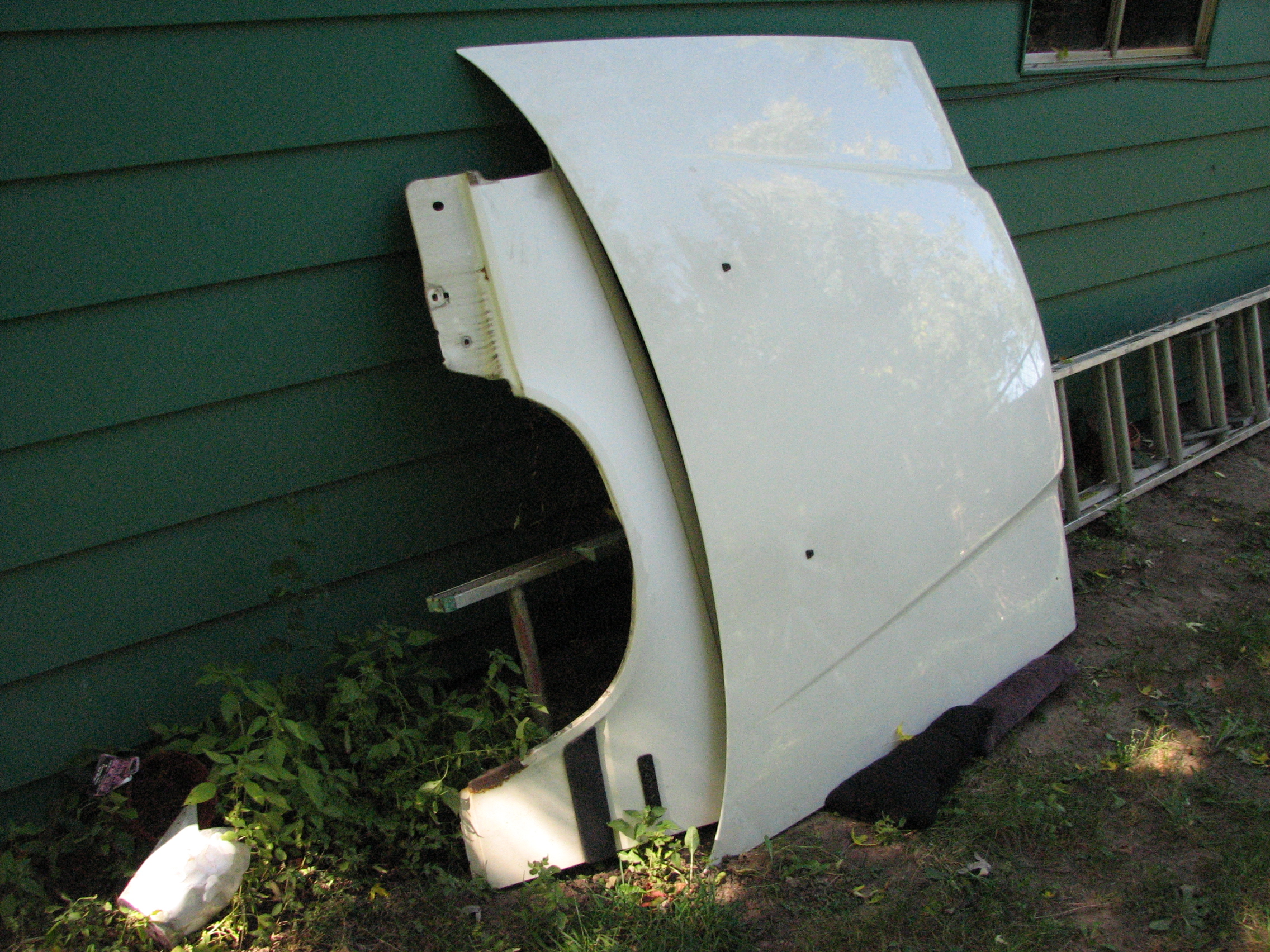

I had also come across (finally) another white 850 last week and grabbed the hood and left fender, ($77.50 total) . The original hood on the Sedan can now be retired since the accident damage is still evident.
After I finish cleaning up some surface rust near the grill the new hood will go on the Wagon, and the Wagon hood will move to the Sedan. It has minor ripples at the rear corners from when the previous owner accidentally let the hood fly up. Not noticeable unless you look closely.
