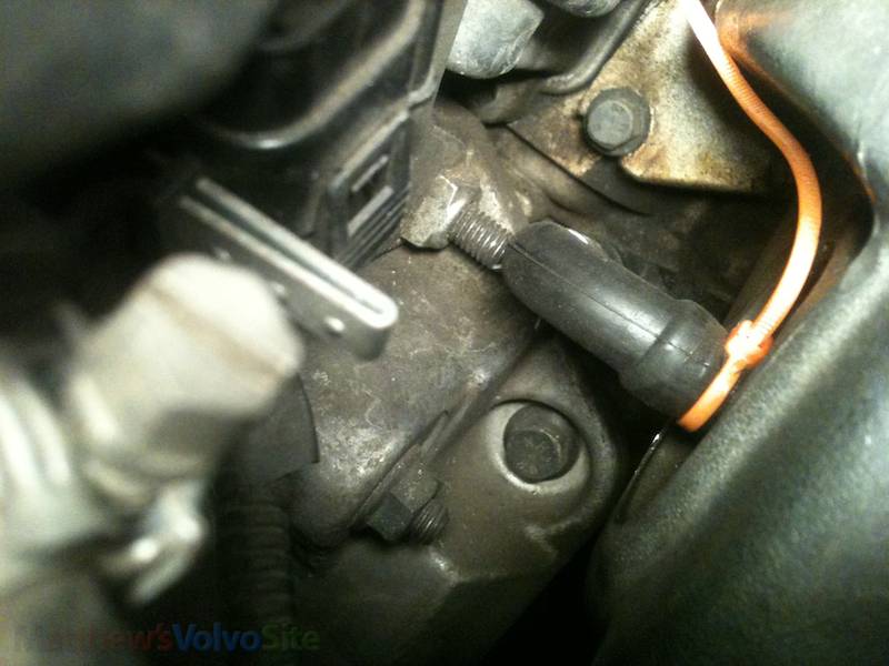

I once had a P0172 from the "evil" elbow vacuum connection on the intake manifold, near the thermostat (left side of engine as you're in front of the car).
https://www.matthewsvolvosite.com/forums ... 35#p213535

Nice pics Matthew. That's the one.

That's the one. Thanks for the pic of this one. I never really thought of zip ties to secure the line thought it might get to hot.matthew1 wrote:I once had a P0172 from the "evil" elbow vacuum connection on the intake manifold, near the thermostat (left side of engine as you're in front of the car).
Thanks
