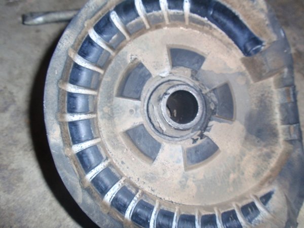

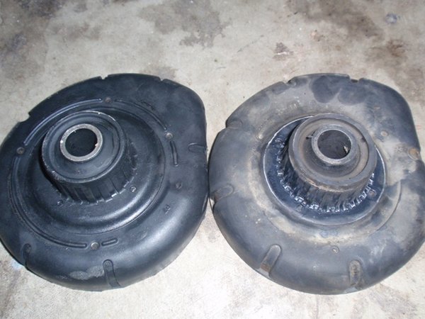

There was a noticeable difference in weight, material, & design between the 850 & XC90 spring seats when I re-redid my my front suspension. The cheap off-brand (Scantech maybe? they were the cheapest available around '08) 850 spring seats FCP used to sale in a kit with strut bearings didn't make it 2 years on my car. I upgraded/replaced everything about a year and a half ago, and when I did, I bought OEM strut bearings & XC90 spring seats. Nothing like doing all that work again.
XC90 on the left Off-brand 850 on the right.
Cheap, clunky, noisy, 850 spring seat after less than 2 years, probably less than 20K miles.
If these cheap 850 spring seats don't exist anymore, that's awesome! No one should have to suffer through those pieces of junk.

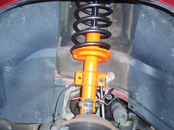

I did a lot of research in an attempt to get a more "sporty" suspension set up with the least amount of drop and on a budget. I wound up with the Koni STRT struts/shocks and an Eibach Pro kit. I was a guinea pig at the time, I couldn't find a single other 850 owner running Koni STRTs. There was a lot of chatter, hear-say, and folks saying they were going to, but I couldn't find any documentation at the time. The STRTs had a pretty good reputation with a lot of other car makes and their respective internet forums so I took the plunge. For what I spent and the results I'm happy. I think if I had to do it again though, I'd try to talk myself into saving for the Koni FSDs, that's a pretty huge jump in price from the STRTs though, hence the "try" to talk myself into them.
I accomplished my goals, it's a firmer sportier suspension, funner in the corners, can drive the car noticeably harder, however when I was driving across Columbus, OH every day for work, there were times that I really wished for a softer ride. All of those potholes, road seams, bridge gaps, etc. were that much more unpleasant after a long day at work. That's where I believe the FSDs would have shined. STRTs are allegedly valved exactly like the softest settings on the Koni Sports, so I don't think the Sports would necessarily be an improvement in my case.
Boy I can get long winded. :oops: How about some pictures?
Eibach & STRT strut assembly vs the Stock "Equivalent" junk I was using.
On the car.
