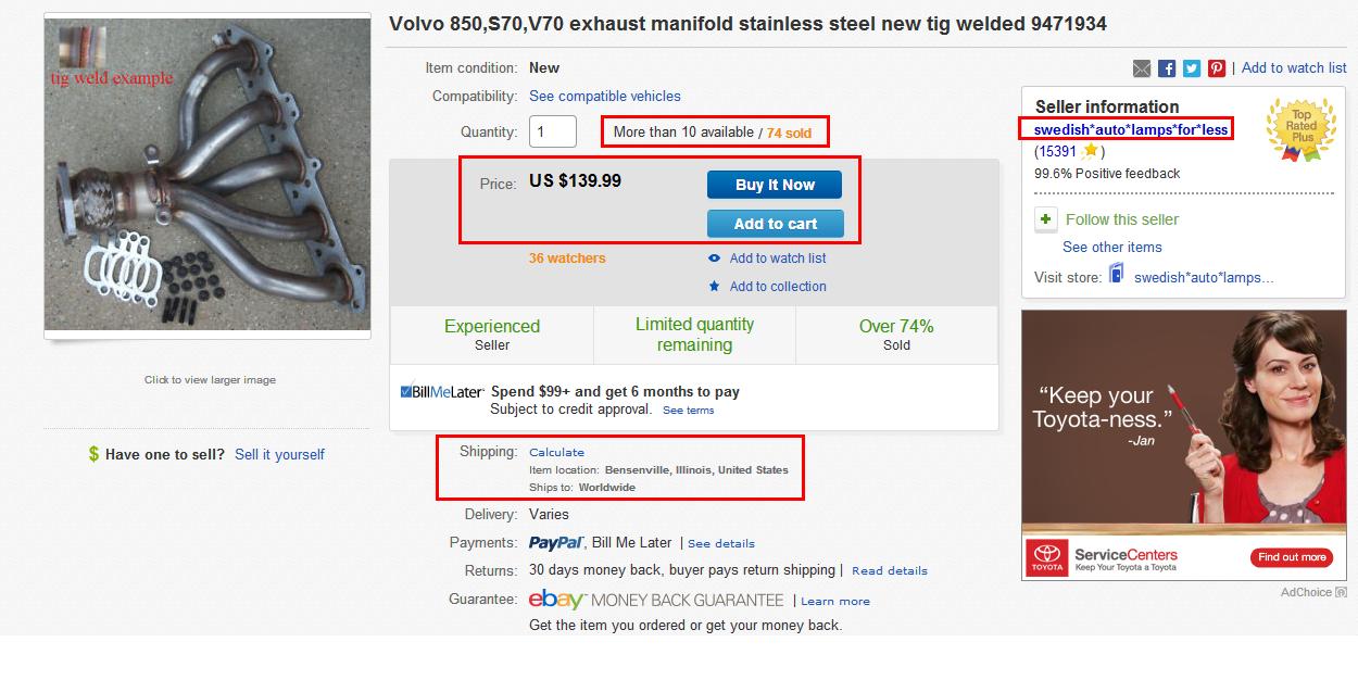

Thanks xHeart for the update.
They are in Chicago area (Bensenville IL).
The same ebay seller sells the "famous $40 Heater Core" that people like very much.
So I expect this Exhaust Manifold to be good at $140...

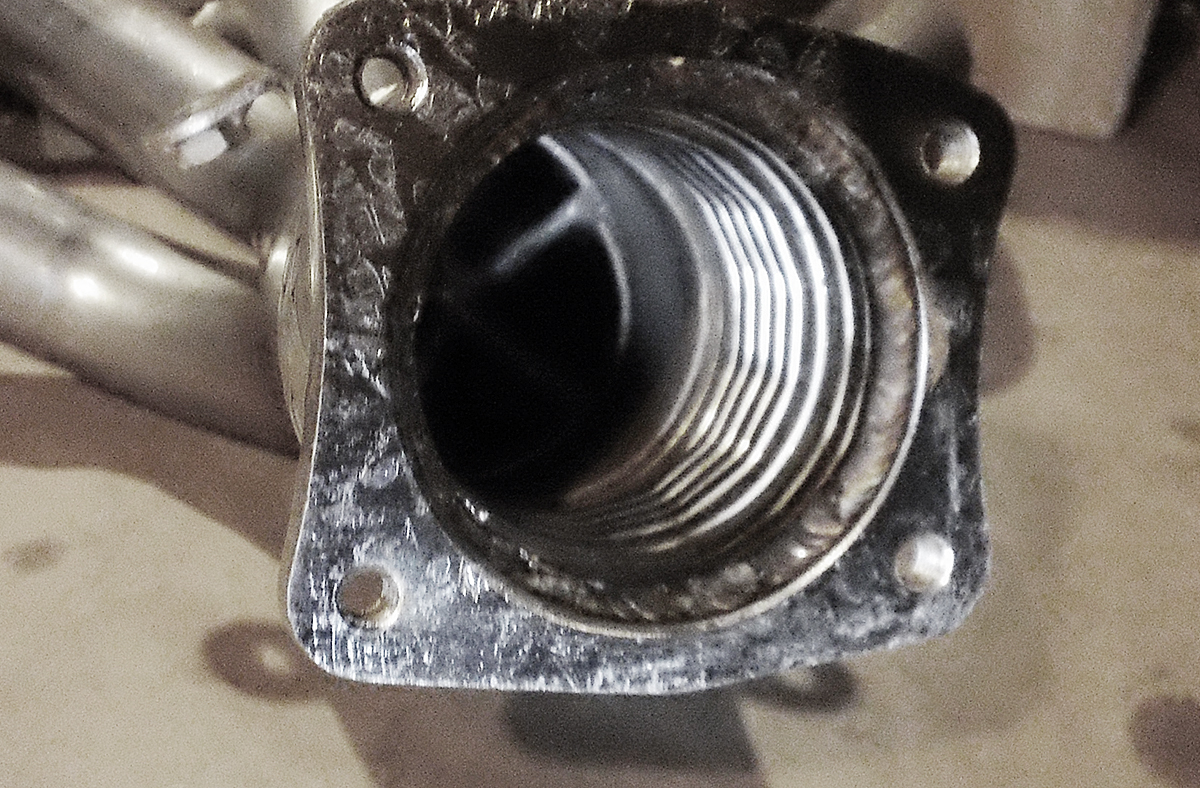

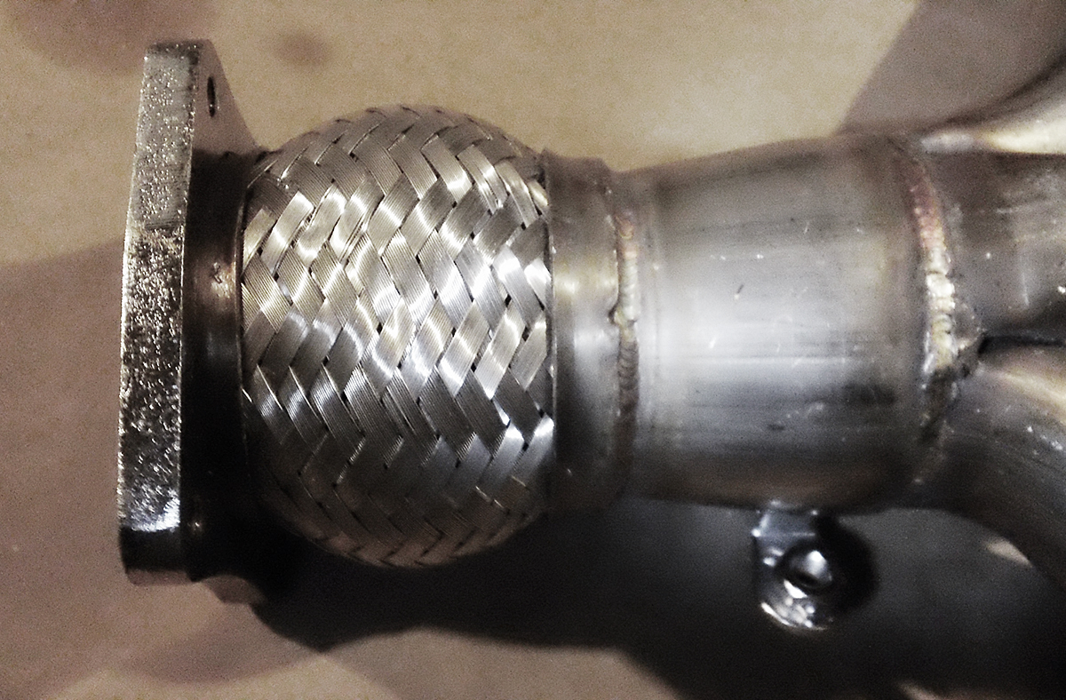

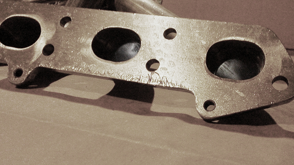

I had enough time last night to pick up. Here are few photos of Estonian variation.
Flex pattern
Flex pattern
Bung angle
Bung angle
materiality and tig welding

surface wrapped with wrinkled/fine hard material

A side-by-side visual of two manifold for area around the flex...any comments?
DNA Motoring
Estonian variation

Out of curiosity...
What is the mesh thing do covering the flex pipe? once damaged and detached, can it be repaired/replaced?

Xheart: I've wondered about that woven steel cover, too. Just a guess, but it certainly can't contain exhaust gases that leak out of the flex, so I'm assuming it's a debris and maybe heavy moisture cover for the flex joint to retard rust from the outside.
