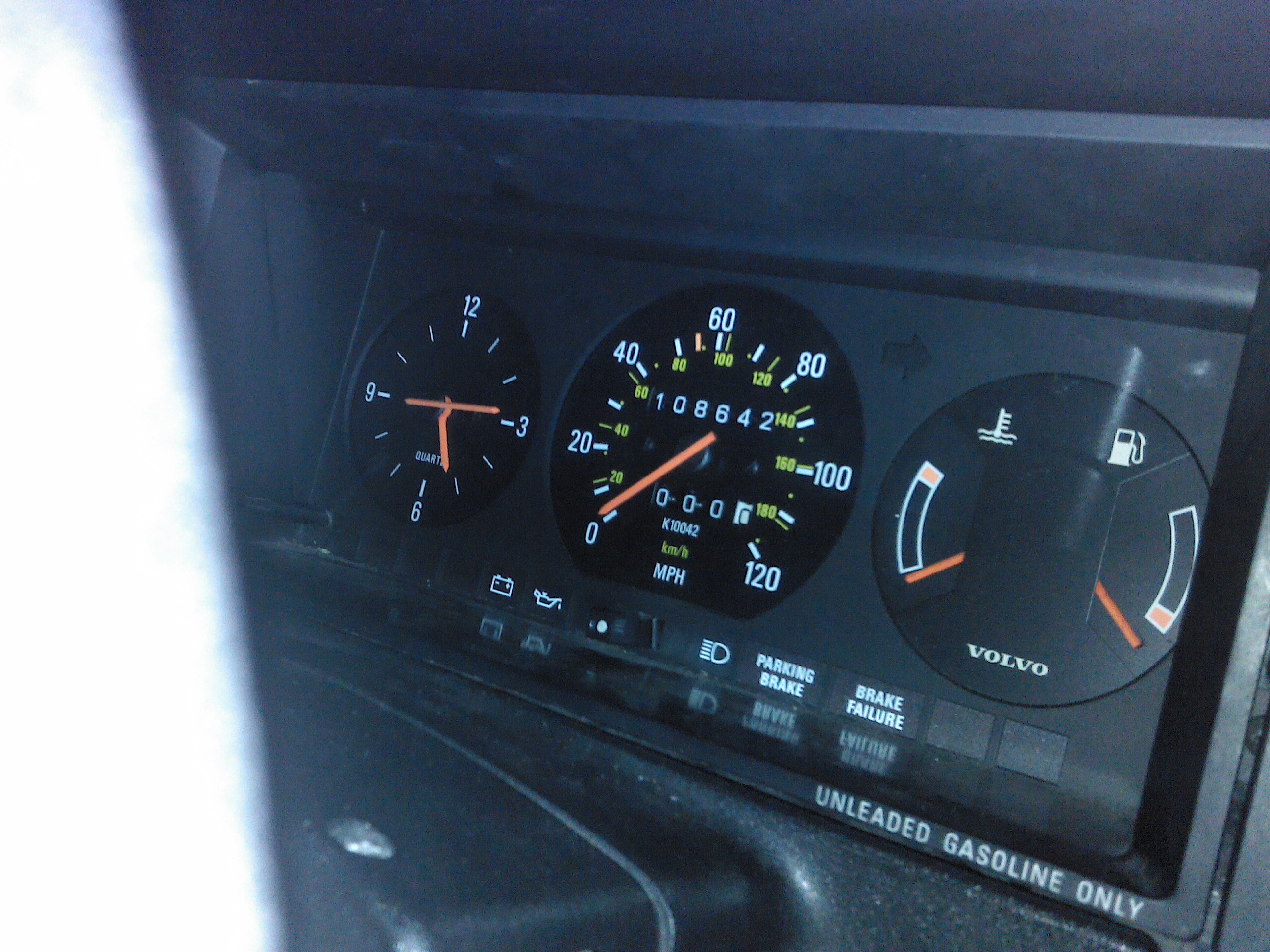

We did a car faq on it came up good and low mile. I would be happy to post some more pictures tomorrow.
