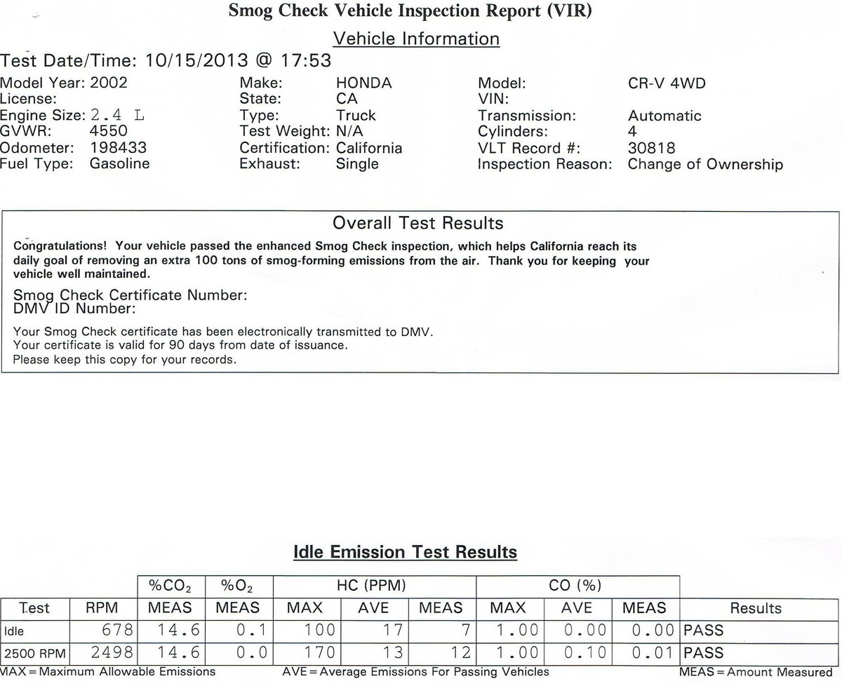

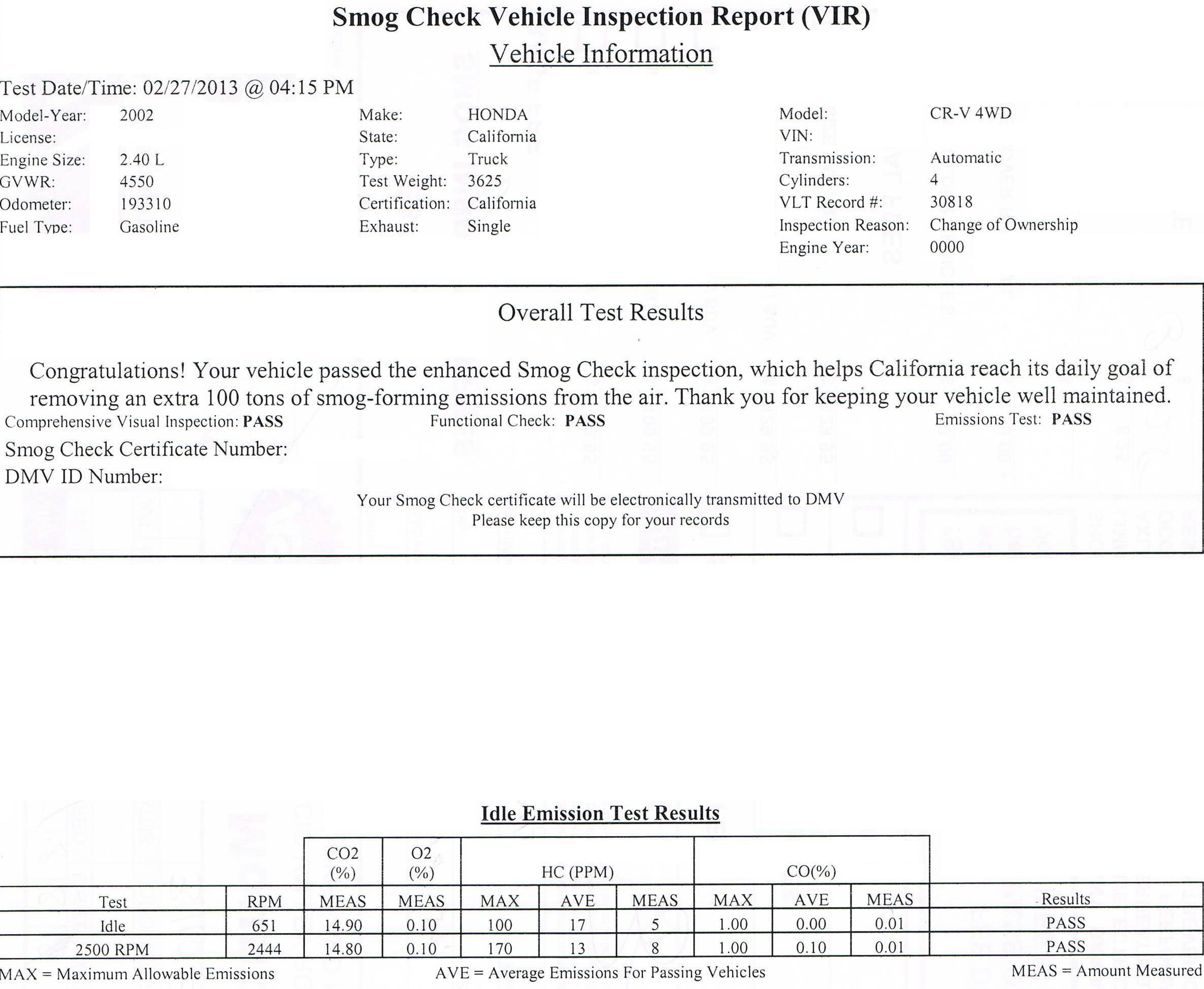

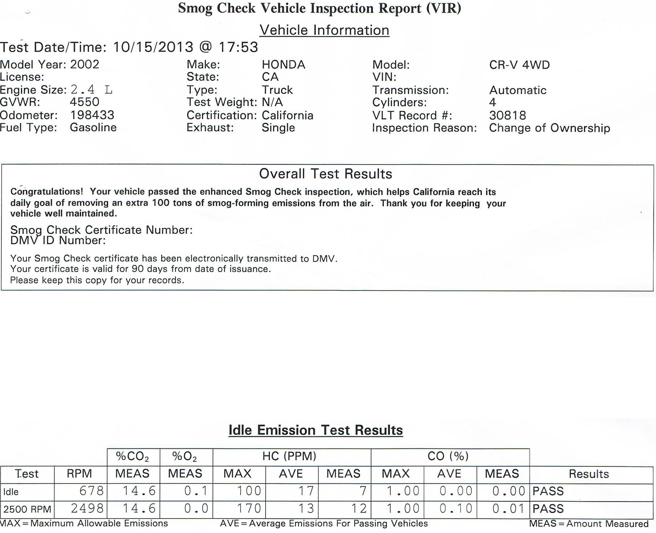

Purchased friend's 2002 CRV with 193K in Feb. The CEL with CAT Code would be on when he owned it for lengthy periods (8 months or more) and he was using Mobil 1 Synthetic and 87 Fuel. He put on about 80K in the last two years of Ownership of mostly freeway to and from work and had to put in half a quart every 1K miles.
Currently I am using a 5W-40 Dino with 91 Fuel. Only other things I've changed were the Air Filter and Spark Plugs. In October 1 week before Smog (was planning on selling) I had to start the car and move it several times on and off the drive way and the constant fresh fuel on a cold CAT triggered the CEL with P0420 for the first time since I owned it. Clear the codes and took it on several long drives and CEL has not come back. Try a different motor oil and run 91, put in fresh plugs if you have to and it may take care it.
I went to a very reputable Muffler shop and asked about a new CAT and it was about $1,500 for the part so he told me since it was not clogged just let it go as the Smog is good for 90 days for a Transfer of Ownership and is only needed every 2 years. Just getting old and not lighting up as it should he said but usable.
