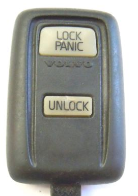

Thanks again to all who responded. You are correct I have the Guard II system. I picked up a remote epray and it worked perfectly!
my remote looks like this - Image
I am a happy camper.

So to be clear, Is the "Guard", or "Guard II" system only in the R in '96, or might it also be in a Turbo wagon?
I have about ten fobs, only one of which is like the one pictured.
I don't remember if I had tried that one yet on my wagon, but I have tried the other two early types with small oval or squared buttons next to each other with no luck.
I think I'll dig it up anyway, check the battery and give it a try.

There is no way to be sure other than to look at the alarm hardware in your car. If they did not have parts on had for the regular keyless - could they have used a Guard at the factory ?- maybe. I can tell you mine has an LED that blinks when the car is locked with key or armed with the remote.
If it is a Guard II then your car will have the remote keyless receiver integrated in the alarm relay located under the dash. It's a black one with a green 5 pin connector on top.
If it is a Guard I then I understand the alarm module is pink instead of black and with a similar connector.
