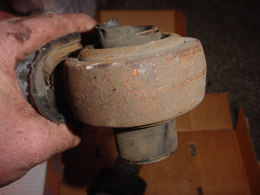

An example of a bad rear endlink.

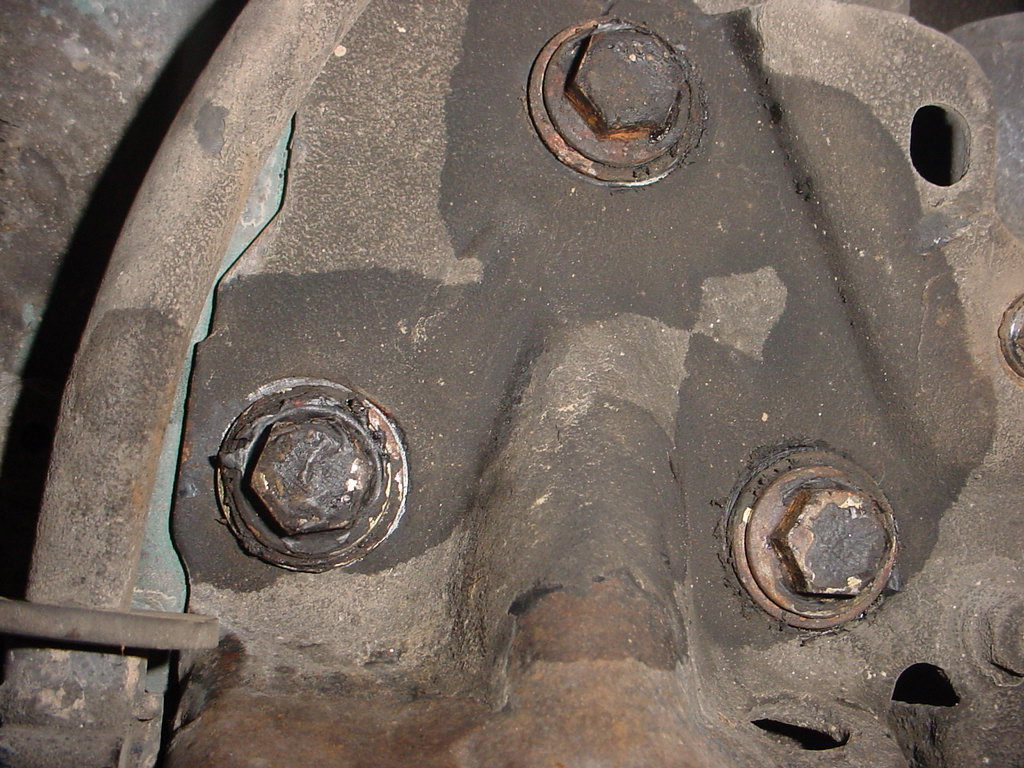

The next step is to remove the bolts from the mounting bracket which are 17 mm socket bolts. In this case I was working on the passenger’s side of the car which is where the fuel filter is bracketed. Take note that you have the fuel filter and the fuel lines in close proximity to the link, it will be important later on. I also removed the fuel filter bracket which requires a 12mm socket. I also used a T-27 Torx driver to remove the parking brake cable from the bracket.
End link bracket bolts.

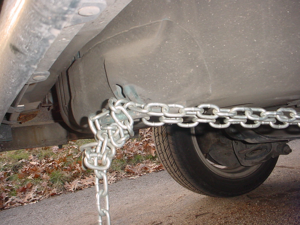

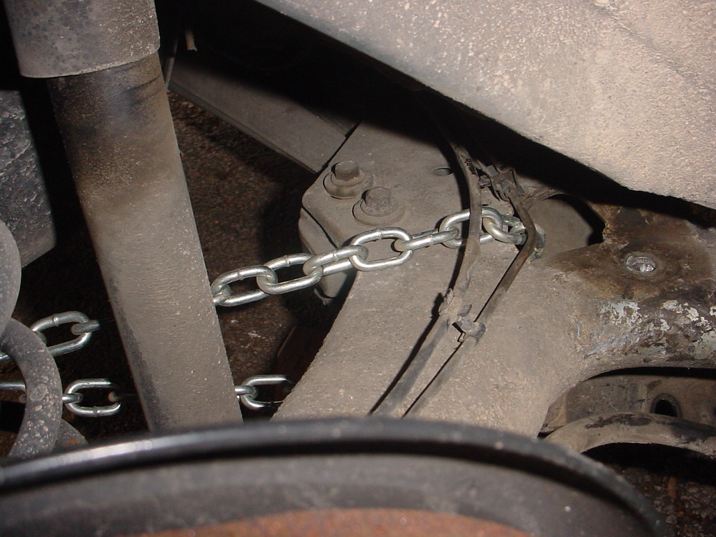

At this point I started to ratchet the come along and found that the delta arms were moving much more than I was comfortable with so I ran a chain through the delta arm and tied the chain through the tow hoop at the back of the trunk (boot?) so as to limit the forward travel of the arm.
Chain through the delta link.
Chain through the tow hook at the rear tow hoop of the car.
I just tied the chain in a knot to secure it through the hoop. Following Lee’s law on knots, if you can’t tie a good knot, tie a lot of them.

In looking at the (albeit ScanTech) replacement endlink I noticed that it was a rubber center with a plastic outer shell. I also noticed that the actual delta arm was aluminum so banging on the delta arm was likely only going to dent it and make the extraction harder. I fired up the torch (remember that you earlier took note that the fuel lines and fuel filter were hanging next to the link) and proceeded to heat the crud out of the delta arm. I still had it under considerable tension with the come along. To my delight plastic began to ooze from the end of the link which meant it was a thermoplastic and it would melt. Once I got it hot enough, and it oozed enough, I took a cold chisel and gave the whole mess a big whack and, just like magic, the end link freed itself from the delta arm.
Note: My attorney has advised me that the preceding procedure should never be done and that it is imperative that you purchase Volvo part number 999 5497 when attempting to remove an endlink.
The old endlink.
The new endlink.

Carefully remove the chain so as to not damage the brake line and re-attach the fuel filter mounting bracket. This is what is should it should look like after repair.
