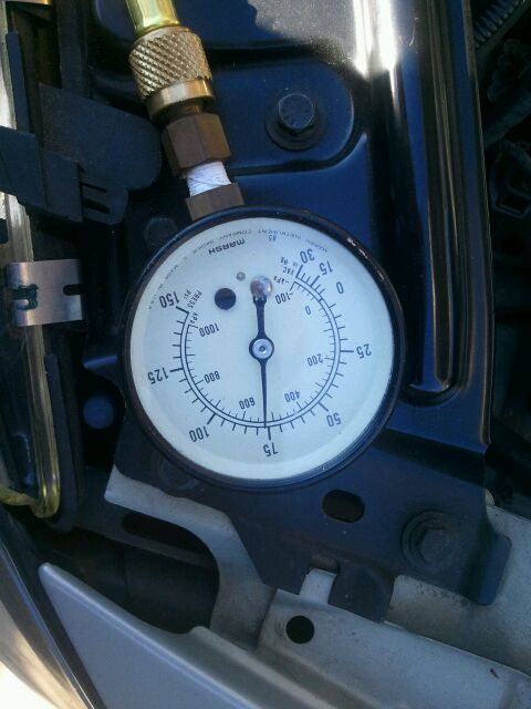

Ok... 75 psi at idle, cold engine. Is this "within specs"? ANYBODY????
Idle, cold engine.jpg (44.49 KiB) Viewed 726 times

Post by jimmy57 »
It is normal.
I have checked several and the cold oil pressure always shocks me.
Run it for a few minutes and it will drop to mid 20's idling.
