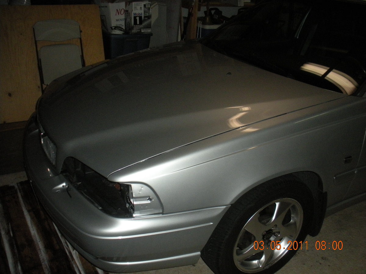

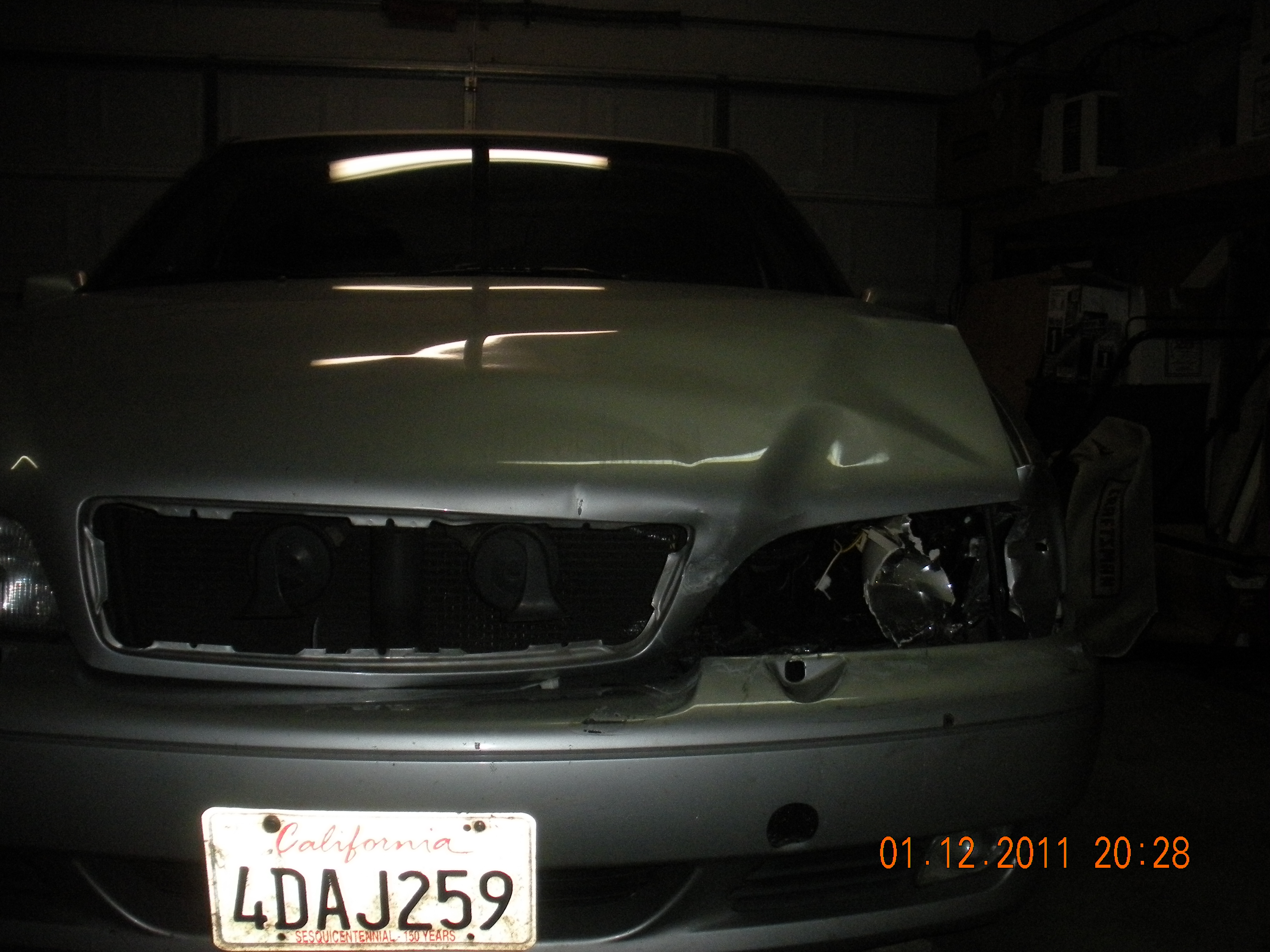

I am researching removal of the ecu and and cleaning of the connections on the unit. I did remove the dash last year ...and when I picked it up...one of the bulbs on the tach....wasnt working...so i smacked the dash and BINGO it started working.....the car is a CA car and I garage it every night.....very clean....I was in an accident in 2011 and they totaled it ....but I had it fixed and it has been great ever since...here is a pic....of the damage...it was fixed by a shop and I sourced the parts all oem volvo body parts....no mechanical needed...
